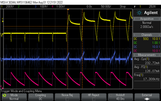

    Below you see a scope capture for a motor with the unusual noise. There is no clock applied, motor is kept in position by means of holding current.
    channel 1 = current
    channel 2 = differential probe over motor coil
    channel 3 = voltage on the decay pin
    channel 4 = voltage on the RCB pin
    In our opinion the DRV8818 does not correctly handle the mixed decay mode, you can see it in the different signals in the scope capture above.
    Mixed decay is only handled correctly in above image see red arrow. In all situations the DRV8818 only applies fast decay.
    What could be the reason? Do you know what is wrong?
    Hope you can help.
    Thanks.
    Harm

  • Hi I'm a collegue of Harm and I would like to add some extra measurements we just did. We increased the voltage on the DECAY pin in the hope that the problem would go away. Unfortunately it didn't we could only make the noise stop by increasing the decay voltage to the point that the chip is in fast slow decay mode only. We also tried lowering the voltage, again the noise stayed until we lowered the voltage to the point that the chip was completely in fast decay mode.
    Next we had a closer look at the two waveforms that the chip is producing: CH2 is the current through the motor winding, CH3 is the voltage across the motor winding, measured with a differential probe.
    normal
    Sometimes we get the above waveform, a PWM pulse followed by fast decay until the current reaches zero. After fast decay, the chip continues in slow decay mode. This is how the chip should function according to the datasheet.
    strange
    Other times the chip alternates to the above waveform. After the PWM pulse, the fast decay mode stays active until the current has actually gone below zero. It is as if the fast decay mode is overshooting. The chip is jittering between these two modes.
    Another thing we noticed is that we noticed is that the jitter goes away completely if we connect a motor with a higher inductance.

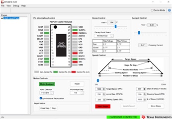

    I have some additional information. We have purchached an evaluation board for the chip,  DRV8818EVM. My collegue is able to reproduce the problem on the evaluation kit. He is using the same motors that are in our instrument.
    Jan Visser
  • My collegue provided me with the Eval board settings that he used for reproducing the jitter. First the settings used for the 1000uH motor:
    Next for the 850uH motor:
    Hope this helps.
    Best regards, Jan Visser
  • Hi Jan,
    It is good that you were able to reproduce with the EVM. This rules out the possibility of the root cause being in your system.
    I noticed that the only difference between the two motors in the VREF voltage for the current chopping limit. If you set the shopping current on the 850uH motor to 0.93A (same as 1000uH motor) does the jitter go away?
    Pablo Armet
