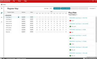

The customer use DRV8353Rx-EVM with InstaSPIN_F2802xF_UNIVERSAL to drive a motor but it does not work. The fault LED is always on.
I asked them to check the Fault status and the results shows problem with the gate drive:
 The customer is feeding the EVM with 48-60V supply and no modification has been done.

    Did they select the "read all registers" button after the fault occurred? Because if there is a GDF reported in the Fault Status 1 register then there should be a fault bit set in the VGS Status 2 register to indicate which MOSFET caused the VGS fault. Could the customer try to read all registers after a fault and see which MOSFET is causing the fault, as well as check to see if the fault always occurs on the same FET?
