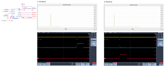

nFAULT pin will Low voltage level when the Motor rotates (UVLO/OCP/TSD will not have this state), is it because of inrush current?

Can you provide a waveform screen capture showing motor voltage, current, and nFAULT line? This will give me a clue as to what fault is causing the nFAULT to go LOW.

Hi Kevin,
It does look like an OCP fault. When an OCP fault occurs, the output will be Hi-Z for t_retry (3ms) which seems to match the time in the waveform. Could possibly be because of inrush current. Will have to take a look at the output current to confirm.
