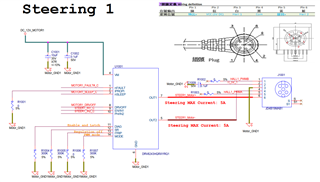

Dear Team,
The attached file is the DRV8243HQRXYRQ1 circuit which was reviewed before.
And we tried to control the motor but not workable.
Below is our logic test. It meets the truth table request.
However, the Motor +/Motor - is not on the correct voltage level.
Can you help to check for this issue? thanks.
VM: 12V
STEER1_IN1_C: 3.3V
STEER1_IN2_C: 0V
MOTOR1_DRVOFF: 0V
MOTOR1_SLEEP_C: 3.17V
MOTOR1_FAULT#_C: 0V
STEER1_Motor+: 0.378V
STEER1_Motor-: 0.378V
Many Thanks,
