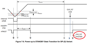

The customer used DRV8243S Variant. And when the DRV8243S works normally, they adjust the VM to below 4V and the device can't work. They found that the VMUV is 0b, not 1b. I guess the  DRV8243S Variant's reaction fixed to retry setting. Is that true? But when they adjust the VM to normal work level voltage, it doesn't work.  Can you explain this case?

  • Hi Hale,
    Thank you for your question.
    When VM goes down under 4V and go under VM_POR, DRV will go to reset state. Even if VM comes back, CLR_FLT is required to wake up. I guess this info helps.
    regards
    Shinya Morita

    "They found that the VMUV is 0b, not 1b. I guess the  DRV8243S Variant's reaction fixed to retry setting. Is that true?" But why did the customer see the VMUV is 0 bit. The VMUV should be 1 bit to show that the device is in under voltage and we set CLR_FLT 1 bit to make it start. Is that right?
  • Hi hale,
    Thank you for your quesiton.
    If VM goes down bellow VMPOR_FALL, VMUV should be turned to 0. POR makes reset all registers. So VMUV back to 0.
    regards
    Shinya Morita

  • Hi Shinya,
    The customer replied that they need to refresh SPI_IN Register and set CLR_FLT 1 bit when the power supply goes up from 4V to normal voltage, then the device can work normally. Do we have similar phenomenon?
    Similarly, they found that when they tested device DRV8908 from sleep mode to operating mode, they need set operation control 1/2 register again and give nSLEEP high voltage level, then it can work normally. If not set operation control 1/2 register, the device has no output. Do you have any suggestion?

    If customer is using SPI_IN function, these register settings also will be reset. Since customer mentioned they need to set CLR_FLT 1, POR could happen and SPI_IN is also reset. I think this could make sense.
    Customer need to re-program all register settings after VM get bellow 3.6V.
    For DRV8908-Q1 question. Please generate new post since this is different device. If VM goes to POR level, customer need to program registers again.

  • Hi Shinya,
    I think we might be confused. The customer need to refresh SPI_IN Register and set CLR_FLT 1 bit when the power supply goes up from 4V to normal voltage, then the device can work normally. And if they only set CLR_FLT 1 bit when the power supply goes up from 4V to normal voltage, then the device cannot work normally. The question is why we need to refresh SPI_IN Register. As the datasheet said, we only need to set CLR_FLT 1 bit. What's the reason?
  • Hi Hale,
    Thank you for our feedback.
    Based on customer's description, I think two possibilities.
    1)Customer made VM lower than 3.6V(instead of 4V), therefore POR happens. SPI_IN register back to default value same as other registers. So customer need CLR_FLT and write SPI_IN again.
    2)SPI_IN is unique register bit. In order to change from default value, first customer need to change "SPI_IN_LOCK" as unlock (10b).
    During customer's test sequence, probably this was not done correctly.
    I confirmed that register settings do not turn to reset/default by VM=4V. So SPI_IN registers also should not be reset/default by VM=4V.
    regards
    Shinya Morita
