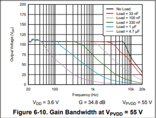

As title, do we have device can support the condition?(Driver up to 3.4uF at 120V and 0.1Hz-1kHz)
Roy
  • Hi Roy,
    Unfortunately those requirements are out of spec for our devices.
    RMS current draw is directly proportional to load capacitance, so a larger load like 3.4uF will reduce the available voltage drive and/or the bandwidth. That reduction ends up limiting the specs below what you need.
