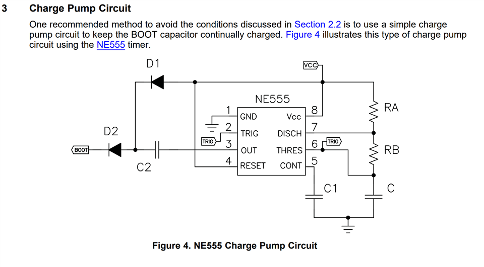

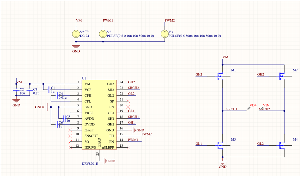

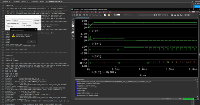

I am trying to find a gate driver that would improve/work for my project. Right now my gate driver is using bootstrap capacitors. I found out a lot of the gate drivers have integrated charge pumps, but they don't have many details on the doubler charge pump. So I found a TI document explaining the charge pump and was not fully understanding it and tried to simulate this circuit with LTspice to understand the circuitry better. And I am still a bit not understanding the circuit that well.
