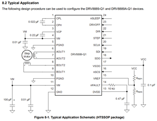

    2. The VSDO voltage should be the same voltage that is powering the MCU. If your MCU is supplied with 5V, the same 5V supply should be powering the VSDO pin.
    A typical application configuration can be found in section 8 of the data sheet.

    The VSDO pin sets the SDO voltage threshold and does not require a certain amperage to activate, only a voltage. Any current pulled to this pin will be regulated.
    Additionally, the SPI logic voltage should be the same as the VSDO voltage.
    Please see the schematic in the hardware files from the following link to view our EVM implementation of the VSDO pin.
    DRV8889-Q1EVM design files:
    https://www.ti.com/tool/DRV8889-Q1EVM#design-files
