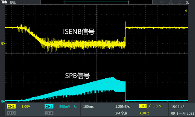

The customer samples the resistor current of the DRV8353RS-EVM using the Bidirectional current-sense Configuration with a gain design of 40 V/V.
But the amplified signal is found to be inverted. Is there a way to correct it? Like adding an inverter externally Or programically invert the captured current?

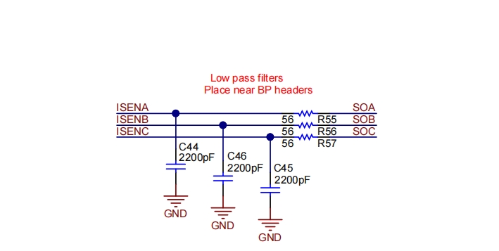

    The SOB actually is ISENB which is just going through a low-pass filter:
    The signal that captures the SPB is essentially the source signal sampled by the resistance. The customer is wondering why the resistor source signal SPB passes through the current amplifier and outputs ISENB. Why is it inverting amplification?

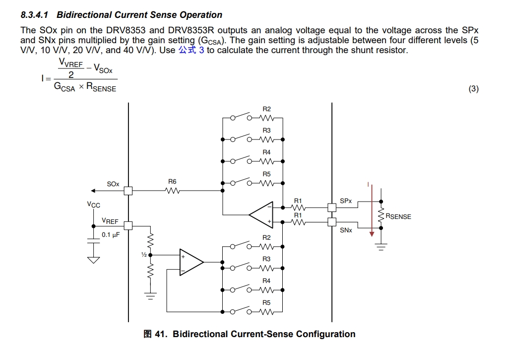

  • Why don't I see the description of this inverting amplifier in the documentation? It is easy to mistake it for a forward amplifier
     unless you look at the picture.
  • Hi Cherry and Gun,
    Apologies for the misunderstanding, the amplifier used that is integrated for current sense I believe is a differential amplifier meaning it will take the difference of SPx and SNx.
    using the image above I can also see that ISENA from your waveform is behaving as expected.
