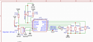

The following circuit use DRV8243HQRXYRQ1 Everting seams to be OK
The signal as flow but the outputs are Hiz
DIAG - 0V
SR - 1.01V
Vitrip 1.89V
MODE 0V
VIPROPI 0V
nSLEEP 3.3V
IN1 3.3V
IN2 0V
DRVOFF 0V
VM -24V
Any idea ?

Hey Ofer,
Did you send the nSLEEP Wakeup/Reset pulse? This is commonly overlooked for this device
Jacob
Thanks Jacob for the replay,
I have connected the nSLEEP to the microcontroller and apply 2ms '0' pulses after 500ms from power up ().
but steel the driver not wakeup is it wrong timing ?
i will check if return the nFault signal to microcontroller and rise the nSLEEP immediate as nFault rise will help.
Can i do the sequences without sampling the nFAULT ?
is and way to apply the wakeup sequences using hardware (capacitors etc') ?
Ofer
Hey Ofer,
The reset pulse on nSLEEP needs to be between 5us and 20us long:
I don't know of a way to implement this with hardware, but I think the correct RC filter would likely be able to apply a 5-20us pulse
Jacob
