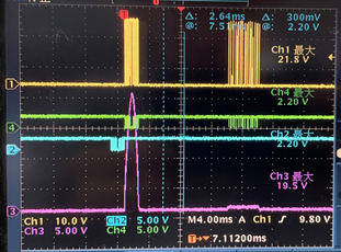

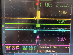

  • Hi David

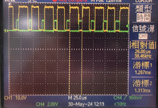

    The waveform is as follows: (CH1: OUT-; CH2: INT1; CH3: OUT- after Low PASS Filter; CH4: INT2)
    1. VM:12V, Loading: Output Connected Coil (6.8ohm) ,Verf:5V, ISEN connected to GND
    2. VM:21.4V, Loading:Output  Connected Coil (6.8ohm) ,Verf:5V, ISEN connected to GND
    3. VM:12V, Loading: Output  no Connected Coil ,Verf:5V, ISEN connected to GND
    3. VM:21.4V, Loading: Output  no Connected Coil ,Verf:5V, ISEN connected to GND

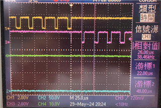

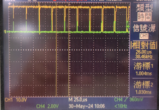

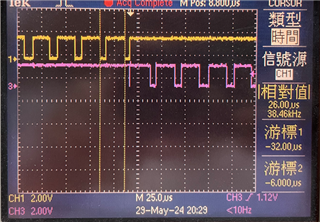

    4. the input signals (IN1 & IN2) frequency  is 38.46KHz.(CH1: INT1; CH3: INT2)

  • Hi David
    I have sorted out some questions as follows:

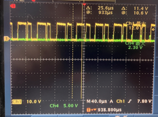

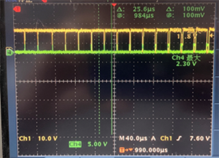

    1. Why are their Output (before & after Low PASS filter) waveforms different between Loading: Output Connected Coil (6.8ohm) and Loading: Output  no Connected Coil? Does the IC have any activation mechanism?
    • VM:21.4V, Loading:Output  Connected Coil (6.8ohm) ,Verf:5V, ISEN connected to GND
    • VM:21.4V, Loading: Output  no Connected Coil ,Verf:5V, ISEN connected to GND

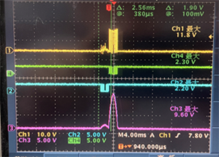

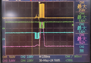

    3. Continuation of question 2, VM:12V, Loading:Output  Connected Coil (6.8ohm), ISEN connected to GND, Vref is 5V. Why does the Output  waveform (after Low PASS filter) change when VM:12 increases to 21.4V ? Does the IC activate any mechanism?
    • VM:12V
    • VM:21.4V

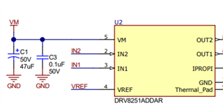

  • Hi Daven,
    I am a bit confused on what the two output waveforms are with one "before" and one "after" low pass filter.
    Are you implementing an external low pass filter on the board?
    Could you please elaborate or include a circuit diagram and layout to better understand?
    David
  • Hi David
    The Low pass filter is just for the convenience of observing the difference in the H-Bridge output signal under different conditions (such as VM, Vref, ISEN). The Low pass filter will not be added to the actual circuit.
    The design requirements are VDD-H: 21.4V (Maximum voltage provided by the motherboard) and the coil resistance needs to be matched with 8.24ohm. The picture below shows the circuit, VDD-H =: VM, Vref =5V or 3.3V; ISEN connected to GND, OUTP & OUTN solder points will be connected to Coil.Have questions about the requirements or circuit design part?
    The layout part hasn’t started yet.  Thanks!!!
  • Hi Daven,
    If possible, I would try connecting VREF to GND instead of DGND. The DRV8231EVM connects all input signals to GND reference.
    The full schematic is available in the hardware files of the DRV8251EVM Evaluation board | TI.com product page.
    David
  • Hi David
    I'd like to know what is the purpose of connecting Vref to GND?  And the Output signal waveforms under different VM voltage & Loading resistance & Vref voltage conditions were previously provided. Under some conditions, the Output signal has a voltage drop. What may cause the Output signal to drop?
    Thanks!!!
  • Hi Daven,
    The output signal drop could be from not enough bulk capacitance. I would suggest increasing the bulk capacitance and the rated voltage they are rated for.
    Example from EVM schematic.
    David
