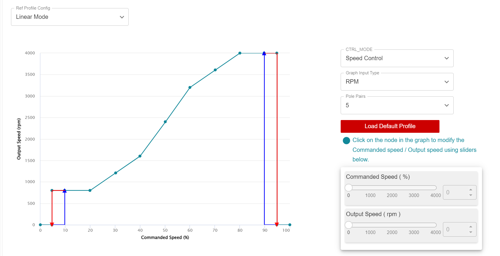

Hello, Dear TI Engineer, when using 8329 to drive a 5-pole compressor, the motor speed is unstable under the condition of constant load of 20psi (there is a pressure relief valve at the rear end), and there is a fluctuation of 200 rpm, resulting in unstable pressure on the pressure gauge. Try other chip drivers and find that it can be stable. I don't know if it's a problem with 8329 or a problem with its own configuration, it's a json file, please check it out.

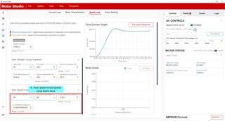

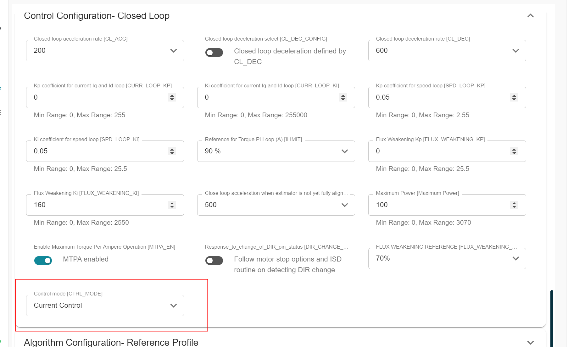

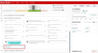

    For using the Closed loop tuning page:
    1. Set the Control Mode to Current Control. This makes it so that the I2C speed command will apply (ILIMIT_setting * I2C_%) current to the motor.

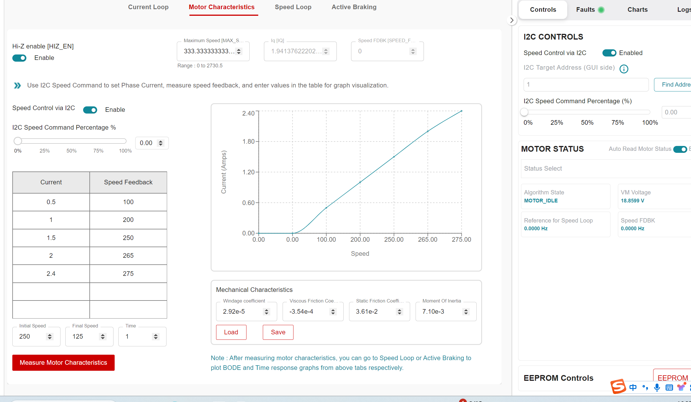

    2. Go to the Closed Loop Tuning Page and go to Motor Characteristics.
    3. Enable Hi-Z using the switch up top
    4. Fill out the table by setting a I2C speed command, measuring the motor current (in Amps) and motor speed (in electrical Hz)
    5. Fill out the coast time by having the motor run at a set speed for a while and then set a zero command. Measure the time it takes for the motor to reach a non-zero speed (in seconds)
    6. Go to speed loop tab to see the recommended speed loop gain settings
    Joshua
  • I tried the steps you said, the fifth step measure motor characteristics will not start after pressing, of course this may be normal, then I turned on the mpet, the motor started and then kept it unchanged at about 150hz, even if it was a long time later, it would not change, the motor would not stop, and the mpet did not report an error. Below is the test page.

  • Ok, thanks for the reply, this was helpful for us to solve the problem. I have two other questions for a professional engineer. 1. When I take the initiative to adjust the current loop pi, if I set kp=0.6, ki=20, the phase current presents large and small waves, four pole compressors, the phase current is a large wave and a small wave cycle, the peak difference can be more than 3 times, is this normal? If I kp=0.6 and ki=1500, the phase current waveform tends to be sinusoidal, the difference between the large wave and the small wave is not obvious, the peak is almost the same, and it is more gentle, which is the same as setting kp and ki to 0 ,the effect is similar, and I would like to ask what is the reason for this situation. Attached phase current picture.kp=0.6,ki=20kp=0.6,ki=20,Noticeable large and small waves,Power consumption is also higher.
     kp=0.6,ki=1500.The large and small waves disappear and the power consumption decreases.
     kp=0,ki=0,The effect is pretty much the same.

  • ok,I can try it.I have one more question.Is there any way to say that this default curve is a polyline, and if I make it a straight line, will there be any instability or other drawbacks?
  • Making the line straight for the linear speed profile should not cause any issues with stability. If you would like to know more about what is being changed by modifying this graph please reference section 7.3.7.5.1 of the MCF8329A datasheet.
