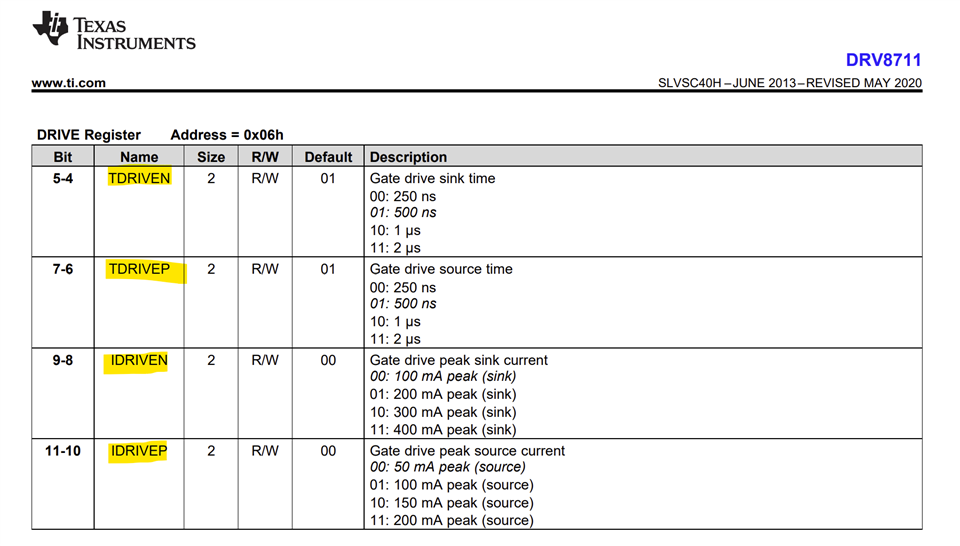

    The Qg of the IRLS4030TRLPBF is higher than the AUIRF540ZSTRL. This means it requires higher current drive setting. Please refer to section 8.2.2.3 Support External FETs in the datasheet, page-35.
    A potential solution could be to increase IDRIVEP and IDRIVEN settings and if needed also TDRIVEP and TDRIVEN settings. Thanks.

    DRIVE Register: 0x650F
    Please verify the above value of the register.
  • Hi Dhivya,
    This translates to lowest TDRIVEP and N as following values for IDRIVEx settings.
    Like I mentioned previously "Please refer to section 8.2.2.3 Support External FETs in the datasheet, page-35." use the formulae in this section to calculate the required settings for your MOSFETs.
    I think you can try setting TDRIVEP and N to 1 μs and increase IDRIVEP and N. For example, try setting 0x6AAF and if that does not resolve try 0x6FAF and if not 0x6FFF.

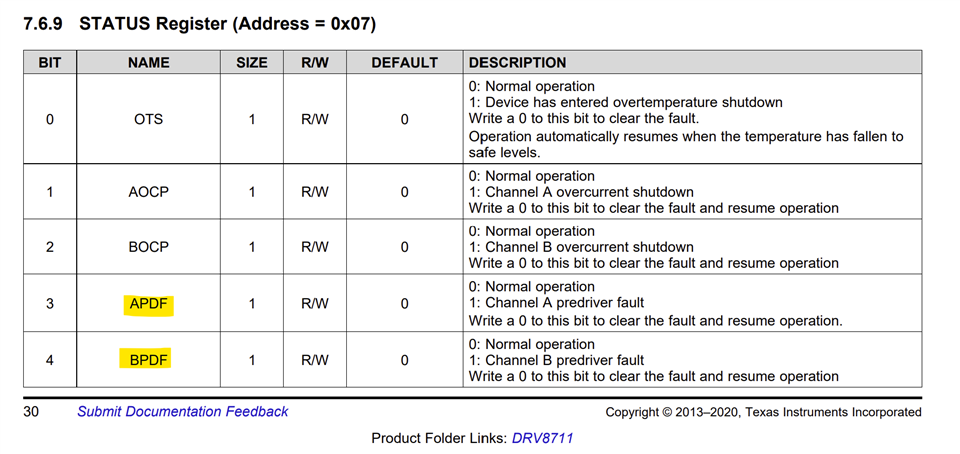

    While the motor is not running with the 0x650F setting can you read the STATUS register and see if APDF or BPDF bits were set? Please share the STATUS register value read for each setting 0x650F, 0x6AAF, 0x6FAF and 0x6FFF. Thanks.

  • Hi Dhivya,
    If APDF or BPDF bits were not set in the STATUS register means the gate drive was normal. Did increasing IDRIVEP and IDRIVEN solved the output issue? Can you please provide oscilloscope captures for the following nodes while the device is actively driving - see below. Thank you.

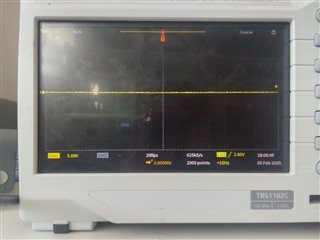

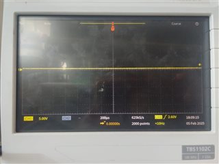

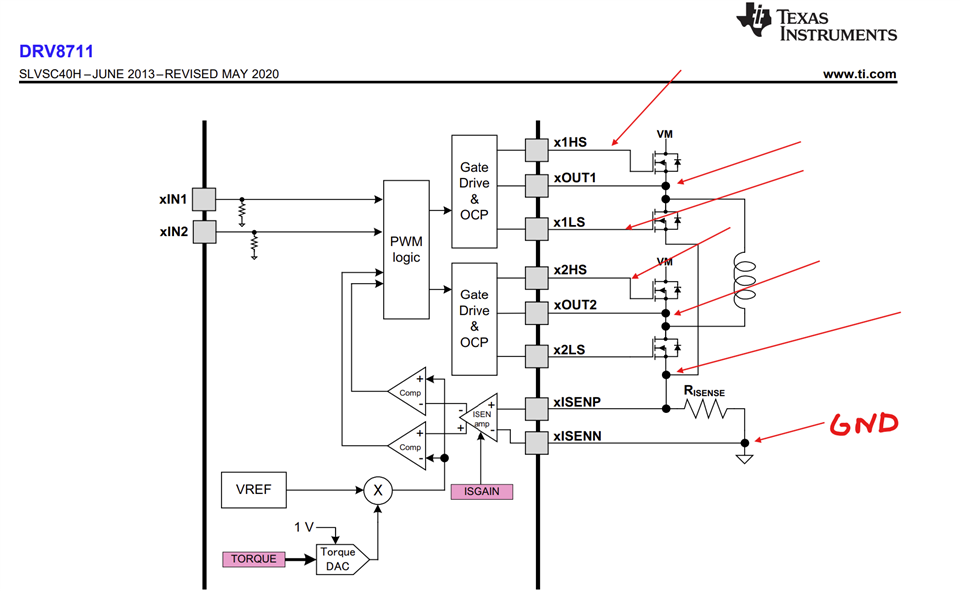

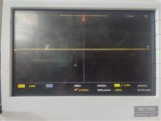

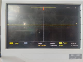

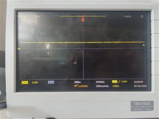

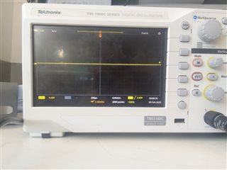

  • AOUT1A1HSA1LSAISENPA1SENNA2LSA2HSA2OUT
    these are images for your reference
  • hello sir,
    we are in need of your support for BDC motor, after setting the full torque register value as 0XFF still the full scale current is not driven by driver to motor
    and our rsense register value is also 0.01ohm.
  • Hi Dhivya,
    It's difficult to tell from the scope captures provide which signal is which. Can you please add labels to these images? If following in order from Murugavels suggested nodes of capture, it looks like x2HS is the only gate that is seeing any voltage. Also please include input control sequence. Is the motor trying to be driven in forward or reverse (with or without PWM)?
