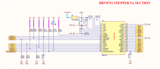

  We are working DRV8711 stepper motor driver with STM32F429IGT6 controller for our application. When we work with the driver, it automatically stopped after running few minutes. We are configured all registers as per driver's datasheet. There is no fault indication in driver when motor not run. So we are using oscilloscope to see the data in driver's SDATI and SCLK lines. We see the data what we send. Then we send register address for to read the our already configured data, BUT in the SDATO line there is no data available in the waveform. Here we added configuration registers of driver and waveforms for your reference.
Our PCB design with Driver for your reference.

  • Hi Narasimman,
    Thank you for posting your question in this forum.
    Thanks for sharing the schematic. The RESET pin has a pullup resistor and capacitor to GND. It is also controlled by a GPIO of a controller. A logic high on this pin will reset the device. The capacitor to GND has no purpose and can be removed. The 20 kΩ pulldown on SDATAI and SCLK is not needed but should not affect functionality as long as the GPIO can support it with correct logic levels. It appears to be okay. The +5V_OUT from the V5 pin must not be used to power any external load except for device pullup resistors. The pullup 20 kΩ may not be sufficient. This pin is a open drain output. Using 3.3 kΩ  or 4.7 kΩ  would be a better choice.

    In addition, be sure to follow the SPI timing exactly as described in the datasheet. When the SCS is enabled 0 to 1, the SCLK must be LOW and SDATAI must be setup by the MCU. The SDATAI input data is latched in by the DRV8711 during the rising edge of the SCLK. Often times this may be possible only if SCLK is setup to be HIGH when inactive - this depends on the MCU. Please check the timing.
    After making these changes please also share SCS, SCLK and SDATA0 waveforms. Thank you.
