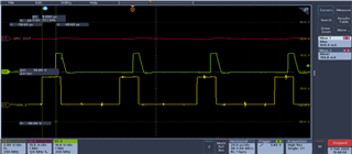

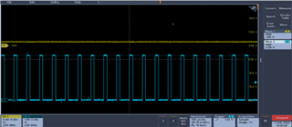

Hi Team,
I would like to know is there any specific settings is needed for enabling the 3rd and 4th channel output?
With H-bridge configuration and Half-bridge mode configuration the DRV8714S-Q1 is only enabling the 1st and 2nd channel. We have tried by giving input to IN3 and IN4 and also remapped the input as IN1 and IN2 but 3rd and 4th channel is not providing the output.
