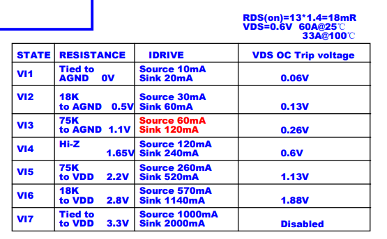

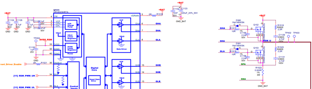

     I want to know how to protect MOS from short circuit burn.
And how long ENABLE pin disable to GH and GL output response delay time.
I test three phase short to GND,MOS burned. How can I solve this problem.
Schematic and setting config as below:
