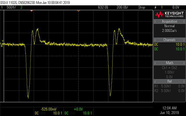

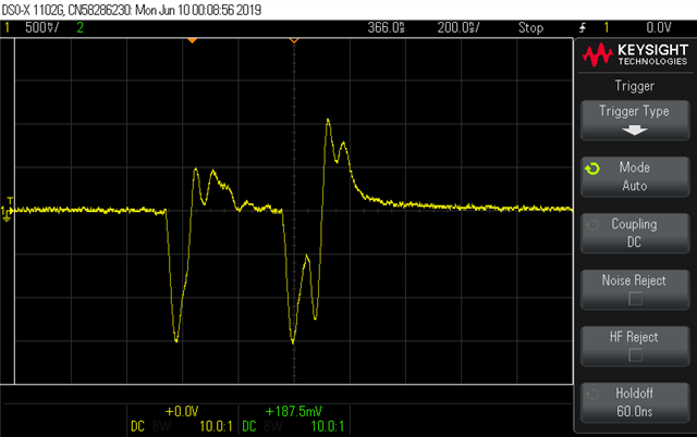

  • Hi Dinesh,
    I replaced the Shunt resistor both with a new 1mOhm resistor and with a 3mOhm Resistor.
    The behavior of the motor did not change much. What would you expect to change when upping the shunt resistor?
    I measured the voltage across both resistor values:
    1mOhm:
    3mOhm:
    Any recommendations on what we should try next.
    George
  • Hi George,
    Thanks for sharing the scope captures.
    I reviewed your JSON once again and found that configured digital dead time is 0. This configuration located at PERI_CONFIG1 -> DIG_DEAD_TIME. Please change it to 300ns and reverify your test.
    Hope you have changed the CSA_GAIN and BASE_CURRENT parameters as per the shunt resister value.
    Dhinesh

  • Hello Dinesh,
    Here is the Voltage across the shunt resistor (1mOhm) at the time of the HW_LOCK_LIMIT fault.
    This was measured with CSA of 40 V/V and a BASE_CURRENT of 0x400.
    There is no short circuit between phases and changing the SPD_LOOP_KP, SPD_LOOP_KI, CURR_LOOP_KP, and
    CURR_LOOP_KI to zero also did not resolve the issue. As is suggested in the tuning guide. Using CTRL_MODE I also wasn't able to get the motor running.
    Thanks George

    Reducing current loop gain changed the behavior. The Motor starts spinning for a short time then suddenly stops and I get a ABN_BEMF fault.
    Could this be related to the current sensing issue when using small shunt resistors, described here:
    e2e.ti.com/.../5949237
    Using current control mode did not change the Motors behavior.
