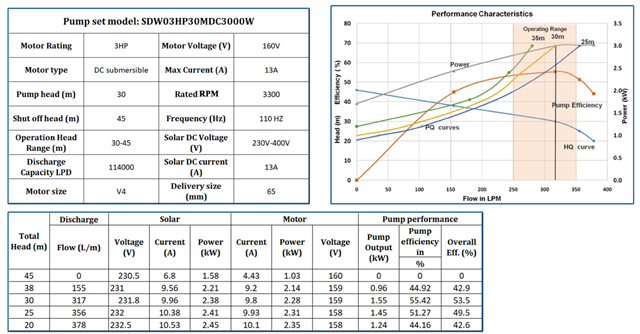

Please suggest me a suitable solution for driving the motor with the below details. Below mentioned Motor is used for Solar water pump
Motor Power 3HP
Motor Voltage 160V
Motor Frequency 110
Based on the above motor details can I assume it is PMSM motor

    I have attached the motor details below
    Can I confirm that the motor voltage is 160V, not 60V? - Yes it is 160V
    What is the expected RMS current? -  Considering the below motor datasheet and I max as 15A . Irms=Ipeak/sqrt(2)= 9.1 A
    What is the expected peak current?  13A
     What DC voltage do you intend to use to drive the motor? from the below data sheet, I am assuming it should be 160V,-  please refer the below motor datasheet and correct me If I am wrong.
    for the below motor details please suggest me suitable driver IC

  • Hey Darshan,
    I am the applications engineer supporting non-isolated gate drivers. It appears that our motor drivers do not currently support up to 160V. I would suggest a discrete solution that would use a gate driver with discrete MOSFETs. The gate driver for this application would be the UCC27710 which is a 600V rated half-bridge driver that is often used in motor drive applications.
    Let me know if there are further questions.
