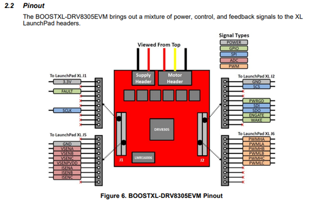

I'm designing an FOC system for motors that we make and wanted to implement FOC as a testing process for R&D into other control methods and/or QA such that we can verify elements of the motor from a controls testing strategy. To that end, I've purchased an F280049C and am assuredly confident in implementing a BOOSTXL-DRV8305EVM to drive a motor for proving FOC as a viable method, but wanted to know if there were higher voltage versions available by TI or if that would require me to design a new driver board using the DRV8305, we're looking for something in the 90-100V range.
Additionally to this, I'd like to know if the BOOSTXL-DRV8305EVM is compatible with the Launch-XL F280049C or if I'd need to purchase an LP-AM261 Eval board as that's what was on the page for the BOOSTXL-DRV8305EVM.

    According to the website, I see the DRV8305EVM is usable "out of the box" with the LAUNCHXL-F28207F for InstaSPIN-FOC or up to two BoosterPacks can be combined with LAUNCHXL-F28069M.
    If you wanted to use the F280049C, you could do it but would have to blue wire over the necessary connections to the headers on the DRV8305EVM.
    You can use this diagram to see the pin out in order to make the proper connections
    Also, in regards to the higher voltage needed, can you clarify if the 90-100V will be the VDRAIN MOSFET voltage?
    The power supply pin (PVDD) to the DRV8305 device has an abs max of 45V.
    You may want to check out one of our higher voltage rated devices DRV8353, which as an abs max of 80V on VM and 102V on VDRAIN.

    Based on VDRAIN being up to 90V as well, I think the DRV8353 is a better suited part for your application. Both the VM and VDRAIN pins on the DRV8305 have an abs max of 45V now that I am checking.
    This being said, the DRV8353 has the evaluation module you are looking for, which can be found here:
    https://www.ti.com/tool/DRV8353RS-EVM
    https://www.ti.com/tool/DRV8353RH-EVM
    The DRV8353 also has both Hardware and SPI variants, noted by the H or S at the end of the package name. So, make sure to select the SPI variant if you want to communicate with the DRV through SPI for example
    On these pages, you can find more information about the evaluation modules in the EVM user's guide in one of the links near the bottom.
    As for the software, you can use the instaspin FOC GUI available for this EVM (Faster bring up, but less customizable), or you can follow the instructions to set up the FOC firmware through the SDK (more difficult to set up but more code customizability)
