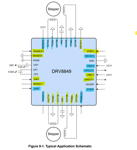

Apologies for a very basic question, but which set of h-bridges does step1, dir1, enable1 control? Out1 and Out2?

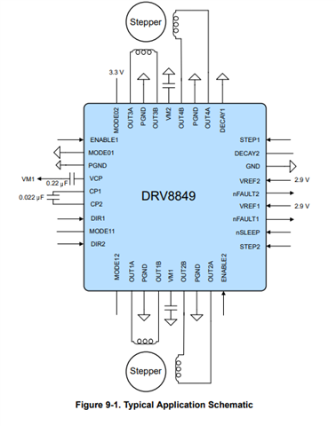

Hi Michael,
Thanks for your question. The Table 6-1. Pin Functions in the datasheet gives specific details on control pins and setting pins for Stepper 1 vs Stepper 2. As well as see below color coded pins that belong to a group.
Regards, Murugavel
