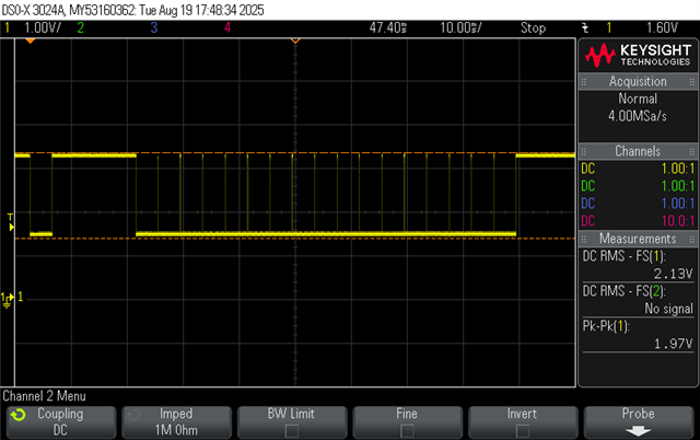

Hey,
We're trying to run the Universal Motor Control Lab on our custom made PCB.
We are currently trying to run BUILD_LEVEL_1. Therefore, the motor isn't connected to the PCB.
We made sure all the connections in our PCB are similar to those of the Evaluation kit(LaunchXL-F280025C + BoostXL-DRV8323RS).
Only difference is that we use the DRV8323S driver on our PCB, and we already verified the SPI communication is working properly between the MCU and the driver.
I am providing the nFault signals as were captured by the scope, hoping it will assist the debugging process.
I would add that when debugging, and going step-by-step through the code sections that seem to cause the nFault to drop, the drops don't happen.
We also placed 33nF capacitors in C9, C10, C11 (boostxl-drv8323RS schematics) as mentioned in the Universal Motor Control Lab user manual.
