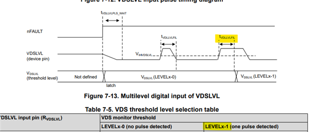

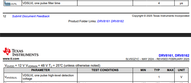

To use LEVELx-1 limits for Over current protection, it is suggested to give single pulse with duration greater than tVDLLVLFIL
Question1:
What is this duration exactly? if system permits to use minimum 100uS, can i use 100us pulse?
Question 2:
What is the pulse magnitude? Can i use 5V pulse magnitude?
Question3:
Is it single time pulse after Gate driver is powered up? After one pulse, can i make this VDSLVL pin 0V?
Sandeep
