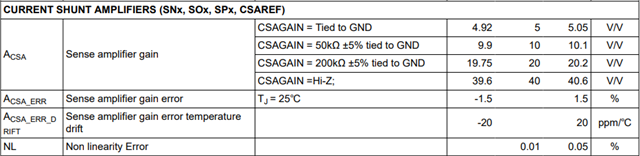

What is the ±error% window of CSA_GAIN and Vref3V (CSAREF)? I need the information to calculate the accuracy of the CSA and the ISEN values.
I saw that DRV8329 has the CSA gain values defined as below, is it of a similar values for MCT8329A?
