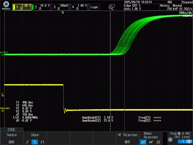

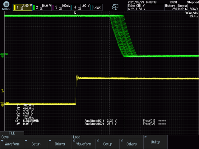

I am using the DRV8803PWPR Quad Low-Side Driver IC.
At output pin i have connected 2.2Kohm resistor and output supply voltage is 24V.
I have placed 100u and 0.1uF capacitor close to IC.
I am getting jitter around 494ns for 100KHz frequency. Why this jitter is coming as my input signal is clean.
How can eliminate this jitter.
    The output jitter is from the input edges that are synchronized (sampled) with the internal digital clock. A digital synchronizer is used for further processing within the output control logic. Because of the asynchronous nature of the INx, the edge synchronizer output could see a variance up to two clock periods which renders as output jitter. This is a behavior in many of our brushed-DC motor drivers. This jitter is common when synchronizing asynchronous input signals.

    There isn't a way to get rid of this from a device standpoint. It doesn't cause issues in motor driver applications. Are you seeing any issues?
