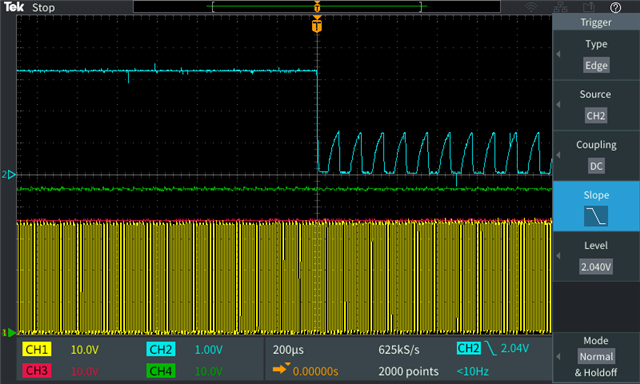

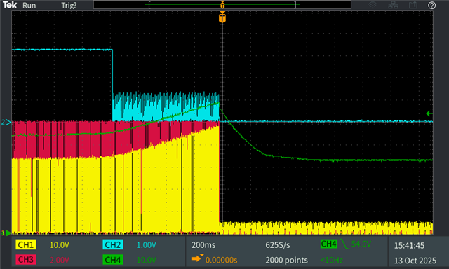

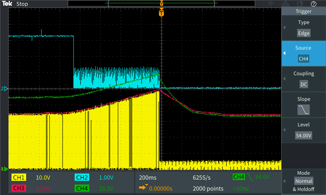

  • Joseph, Uploading a couple of images to explain my issue. In both images: Channel 1 (yellow) is the Mot_A signal to one of the motor coils, Channel 2 ( blue) is the nFAULT signal, Channel 3 (red) is PVDD, Channel 4 (green) is VCP. The first image shows the initiation of the slow down signal from 10,000 rpm at 200 rpm/s. The nFAULT is first triggered by PVDD going over 35 volts and looks like is pulsed for the first ~800ms, as intended for that WARNING. Over the next 800 ms (see the second image that shows a longer time frame) the PVDD and VCP rise and eventually the VCP exceeds 60 volts, which shuts down the output and pegs the nFAULT to 0.

    Thanks for the waveforms. I can see the behavior you describe. At least the device's protections are working properly!
    To me, this behavior seems counter intuitive as I would expect motor current to decrease with a lower target RPM... Have you probed the inputs and gate signals during this condition to see if they match what you expect from the code? (E.g. lower duty cycle on input pwm)
    Joseph
  • Hi Joseph,
    Yes, I am definitely glad that the protection is working - haven't fried the board, yet!
    I believe the reason for the PVDD and VCP voltage increase is due to the back-EMF coming from the motor. Specifically, I think the issue may be "VM pumping". If I command the reduction in speed at a slower rate, for example 50 rpm/s instead of 200 rpm/s, I don't see the voltage PVDD or VCP go up at all. The issue is that I want to slow down at 200 rpm/s and faster and don't know how to address the problem within the DRV8305-Q1EVM hardware architecture - I think I may need to implement a software solution, but not sure what exactly I need to do.
    As far as the Gate signals, I am attaching two images, where the red channel is now GHA voltage. The GHA voltage seems to behave as expected. I am not sure that is a problem.

  • Hi Rostislav,
    Thanks for the extra info. I agree that this is the issue is VM pumping now that we see the gate behaving as expected.
    Now we have few options to prevent this issue.
    The easiest and most reliable solution will be to use a TVS diode as mentioned in the VM Pumping FAQ you linked. I understand this would add extra cost to the system but it would be a simple way to resolve the issue. If you would like to pursue this solution I can provide additional advice later.
    Software solution may be possible, but this approach would be much more difficult and I could see potential problems arising.
    As for your second question, yes, this is because the operating voltage meant for this device is 24V.
    As a rule of thumb, we spec the abs max voltage of the device at around 2X the desired operating voltage to provide very safe/high abs max values for the target voltage rail, which is why you see a 45V abs max for the device, but protections kicking in at 35V.
    If you would like to operate at 48V, I can recommend the DRV8363-Q1, which is one our our latest and greatest devices that also has the ASIL-B automotive rating. EVMs should also be available for this device. However, the EVM operates with sensored trapezoidal commutation out of the box and you would have to write your own software to pursue FOC commutation.
