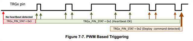

DRV3901-Q1: deployment abort
Part Number: DRV3901-Q1
Hello Ibinu
I would have a question regarding the deployment delay possible on the pyrofuse driver. In case of deployment command received by PWM on TRG pin, if within DEPLOY_DLY the PWM stops, will the deployment still happen? Is there a possibility to delay the deployment and cancel the deployment if the deployment command is no longer sent to the driver?
Please let me know if you want me to set up a short meeting with the customer to explain.
