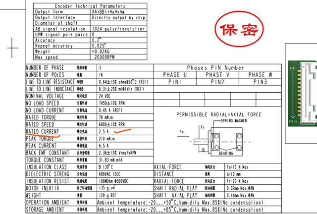

  • Subject:  MCF8316C-Q1: Motor runs no-load but stops under small load — CURRENT_LOOP_SATURATION & CONTROLLER_FAULT in MotorStudio
    Hello Venkatadri,
    I am using the MCF8316C-Q1 DVK evaluation kit with the MotorStudio (Three Phase GUI) to drive a FL45BLW23 BLDC motor.
    The motor starts and runs smoothly under no-load conditions up to the rated speed. However, when I apply even a small mechanical load, the motor immediately loses torque and stops. The MotorStudio GUI reports the following faults:
          CONTROLLER_FAULT
    Sometimes also
          ABN_BEMF or MTR_LCK
    I have attached a screenshot from MotorStudio showing the configuration and faults.

    Motor Parameters (from SmartTune / GUI):
         Phase Resistance (R): 0.4000 Ω
         Phase Inductance (L): 0.1550 mH
         BEMF Constant: 13.000 mV/Hz
         ISD State: ISD_COMPLETE
         Speed Feedback: ~3409 Hz (no load)

  • Hi Aniruddha,
    I looked at the motor datasheet and I see that the current to be entered is less than 2.5A, which is mentioned as the rated current. The 6.5A may be the stall current.
    The current loop saturation flags indicate that the device cannot increase current further because the motor has already reached its maximum speed for applied voltage.
    This is because, for 6A input, the device divides the entered rated current into a few steps to analyze mechanical properties. When there is no load, even for a smaller current step, the motor would have reached its maximum speed.
    We have explained such scenarios in the FAQ and application note.
