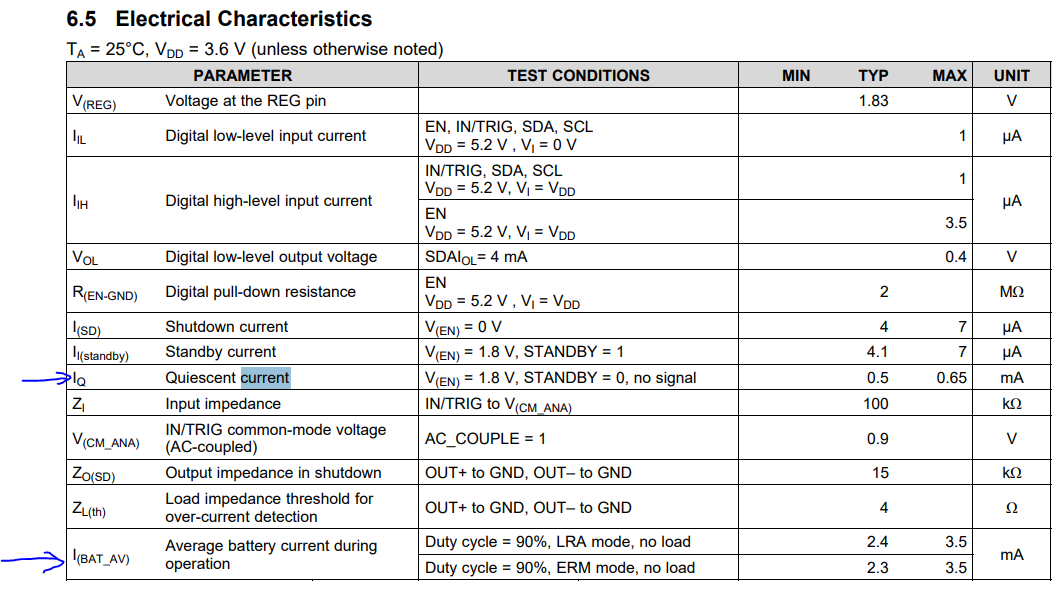

As i am planning to use VG1040003D with Haptic Driver DRV2605L https://www.vybronics.com/coin-vibration-motors/lra/v-g1040003d.
I want to understand the Current consumption details so I can make the device working with battery and with longer life.
From the datasheet I got following info so just want to confirm:
  1. Active current by DRV2605L when LRA working with haptic driver , current consumption for 2.5VAC, LRA is around 75-85mA .
  2. Quiscent current itself is 0.65mA.
Also, Do you have any other driver with low quiscent/standby or active current ?

  • Hi, please check out the DRV2624/25. These devices are designed for low-power applications like wearables.
    If you need a leaded package, then DRV2605L is the only option with the VSSOP package.
    I'm not sure I understand your findings on the current consumption.. In general, when not in use, put the device in Standby and consume <7uA. The current consumed by the device in Active mode is <0.65mA.
    The device current when driving an output signal in LRA or ERM mode is <3.5mA -- I'm pretty sure this is in open loop for testing purposes. The output is a class-D signal at 90% duty cycle -- so near max output voltage when supplied by 3.6V.

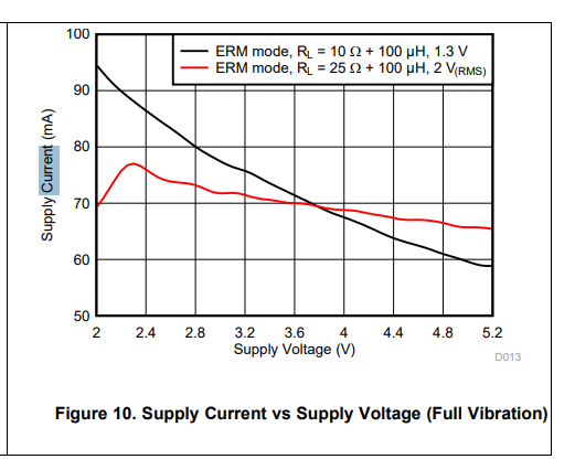

    Okay I understood that the Closed loop current will be lower than the 3.5mA. Just want to understand that which current has been shown in the figure 10 ?
    As My LRA part needs 170-200mA max as per the spec so the internal H-bridge is able to provide this right ? As I am unable to derive this from the Datasheet of DRV2605L.

    I see how this plot can be confusing. Both of these lines are in closed loop and include the actuator current as well as the quiescent current (full supply current). There is a typo here. The "ERM Mode, RL = 25Ω..." is actually LRA mode, hence the RMS voltage.
    You can drive this LRA, but you may need to disable closed-loop per the Vybronics website. The load current will be a product of the impedance and the voltage you drive.
