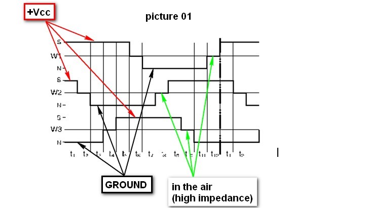

    From the motor go out three wire.
    For that the motor to spin every single wire must be connected
    to +Vcc, ground or leave unconnected as shown in the picture 01.

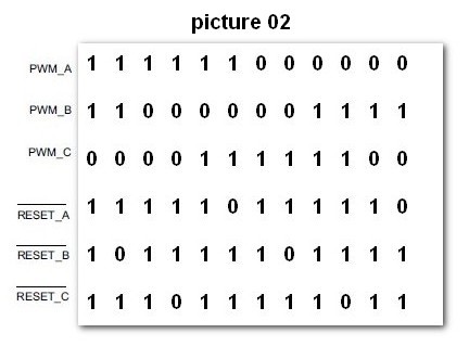

    In order to obtain those waveforms at the output of the DRV8332 driver,
    command sequences, according to datasheet, should be those outlined
    in the picture 02 ?

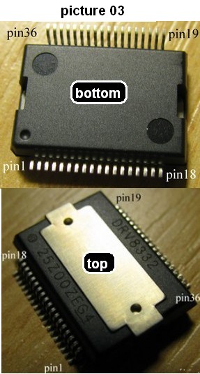

    Pin numbering is according to the picture 03 ?

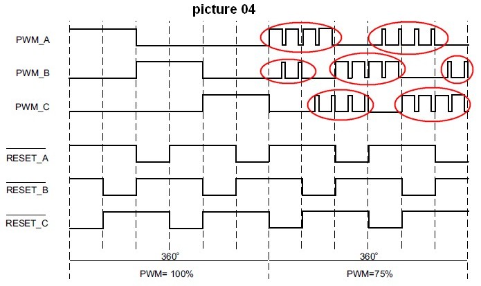

    That minimum PWM switching frequencies of 10 kHz (maximum 500 kHz)
    is the one that corresponds to the circled areas in picture 04 ?
    The waveforms controlling the DRV8332 (except the reset signals) consist
    of a low frequency PWM whose levels are generated by a high frequency PWM ?
    And if so, the low frequency PWM is the one that make the motor running
    step by step and the high frequency PWM is that minimum 10 kHz signal?
    Which is the slowest PWM signal that DRV8332 can generate such that
    the motor spins at low speed ?
