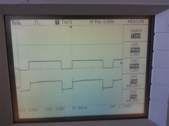

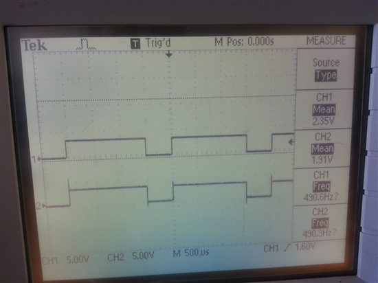

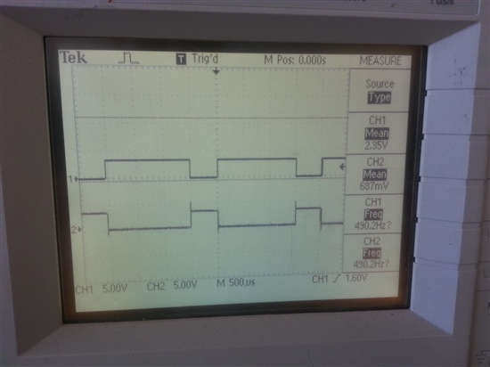

  • Hi Nick,
    I have tested the two half bridge outputs of the power driver to a 3V DC PVDD voltage. Unfortunately, the scope im using only has two inputs, so i have included the photos in two seperate lots. I used a 25% duty cycle PWM wave with a maximum of 3.3V at 100% duty cycle. I also tested the voltage of the mode pins, and they are at the correct voltage levels for M1 and M2 to be high and M3 low.
    It was my understanding that the output voltage would switch across the OUTA and OUTB ports. I have also included a shot of the output across A and B to the PWM input.
    For all images below, the PWM input is Scope 1, and the output is Scope 2.
    Image 1: Half Bridge 1 (Output A to GND)
    Image 2: Half Bridge 2 (Output B to GND)
    Image 3: Full Bridge Output (OutA to OutB)
    Any help you could give would be fantastic!
    Vaughan

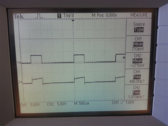

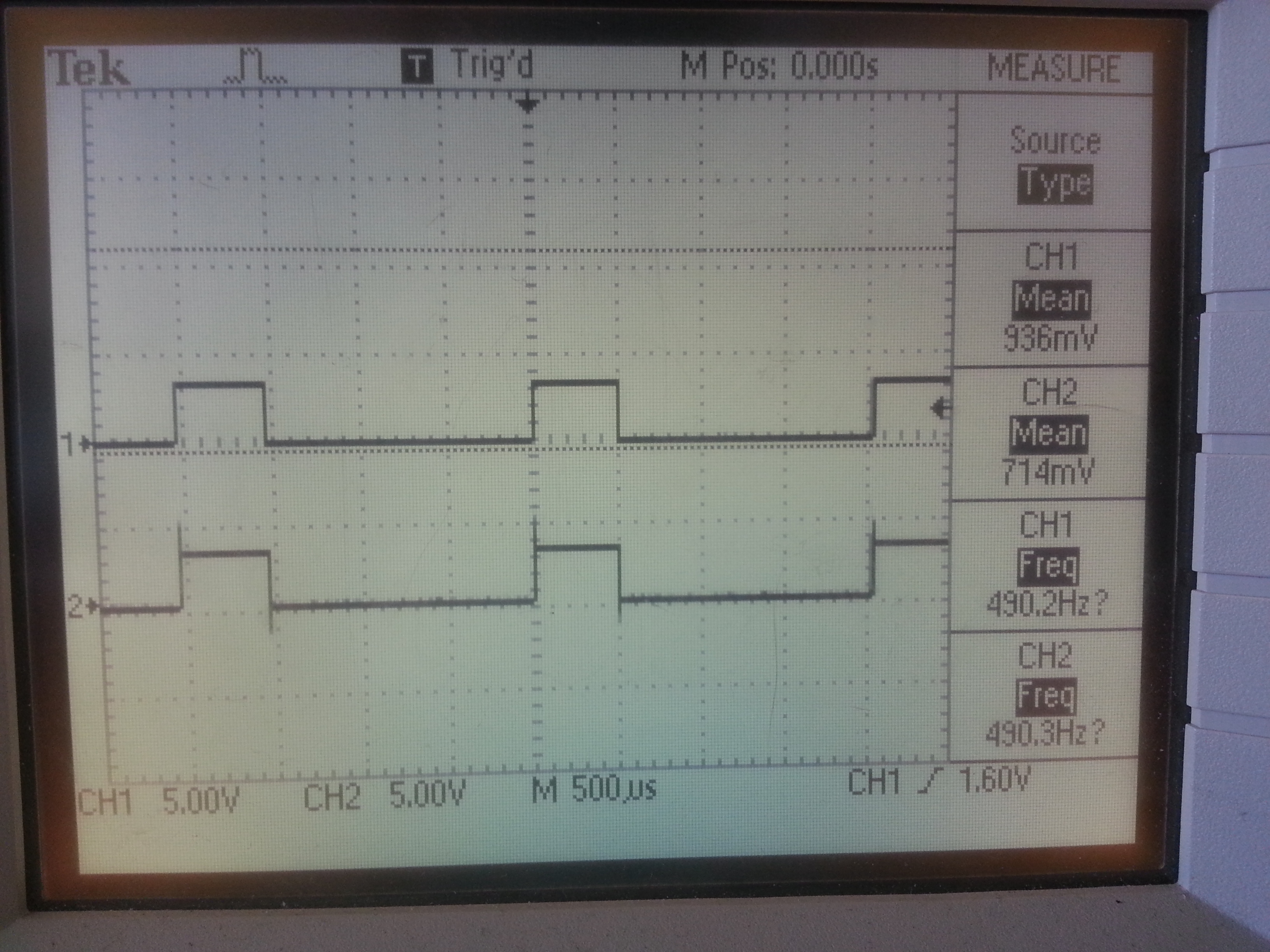

  • Also for comparison, here are the same shots at 75% pwm duty cycle with a 3V DC PVDD input.
  • Hi Nick,
    It appears the Power Driver works to switch the output across A and B. I just wasnt seeing that on the scope, but it does seem to be working.
    Thanks for the help.
    Vaughan
  • Hi Vaughan,
    From your scope shots, it appears the device is functioning correctly. Has your question been answered? Please elaborate if you have additional questions.
