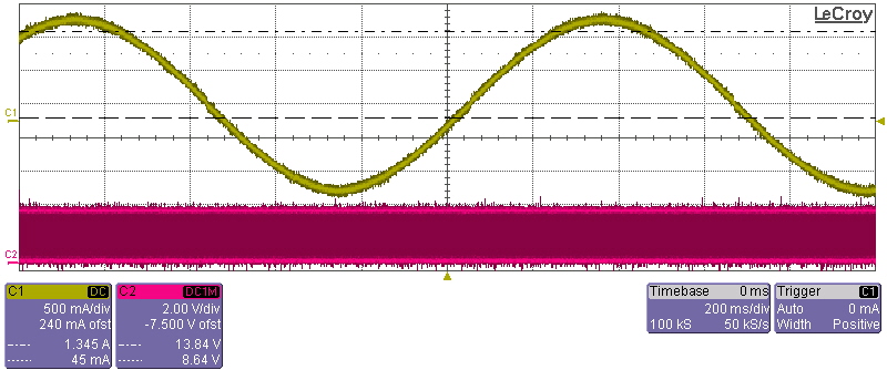

  • Hi Wilson!
    Thanks for your answer.
    I did smoe experiments with the values you suggested and some tests with register settings around the boundaries you have mentioned.
    I have attached two screenshots of the measured current waveform for following register settings:
    - 1.33A full-sclae current, 256 microsteps
    - 25us OFF time
    - 4us blank time
    - 12.5us decay time, auto mixed decay
    - 300mA LS drive, 150mA HS drive, 500ns LS and HS drive time
    - step frequency is 800Hz

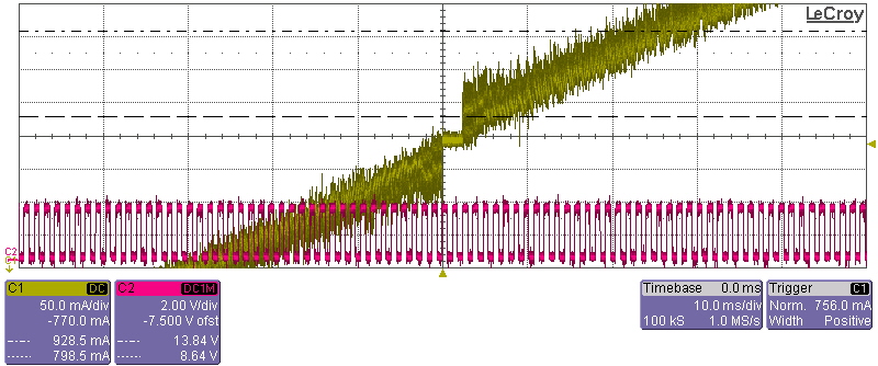

    The screenshot pic1 shows a full period of the current waveform (yellow graph - current waveform; purple graph - signal at step input). The screenshot pic2 is a zoom at the zero crossing of the current. There is no continuous gradient of the current which results in a cogging movement of the motor. The duration of the zero current zone is nearly 2.5ms.

  • Hi Michael
    It looks not bad. To lower the zero crossing distortion, you can enable the ABT bit to enable the adaptive blanking time function. I think that will help.
    Wilson Zuo
  • Hi Wilson!
    Thanks for the hint with the adaptive blanking time function. However it doesn't increase the performance.

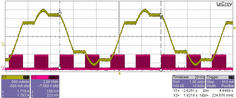

    Now I have another question. I am using a stepper motor with 0.9° resolution (400 fullsteps for 360° rotation). So the DRV8711 should drive a current similar to a sinewave through the coils of the motor for each fullstep. Is this correct?
    The following screenshot shows the current with 500ms delay after each fullstep (divided by 256 microsteps). The DRV8711 needs four fullsteps to generate a full periode of a sinwave.
    So maybe the reason of the cogging isn't the zero crossing but a faulty functionality of the driver?
    Thanks and regards,
    Michael
  • Hi Michael,
    I think your understanding is slightly off. A bipolar stepper motor will actually move 4 full steps in a sine wave.
    To understand this. Think of a stepper motor in full step mode. There are two phases, A and B.
    The combinations are...
    A   B
    1   1
    1   0
    0   0
    0   1
    For each of these combinations the stepper motors moves a step. Microstepping holds the motor between these positions in an attempt to make these transistions smoother.
    So your waveform makes perfect sense! Wilson can correct me if anything is explained incorrectly

  • Hi Nick!
    Thanks for correcting my misunderstanding.
    I asume that current level at the end of a fullstep is depending on the electrical angle.
    I think that the cogging torque of the stepper motor is too high and so there is no smooth movement possible - neither by using 256 micro steps.
    Do you have any idea to compansate the effect of the motors cogging torque?
    Michael
