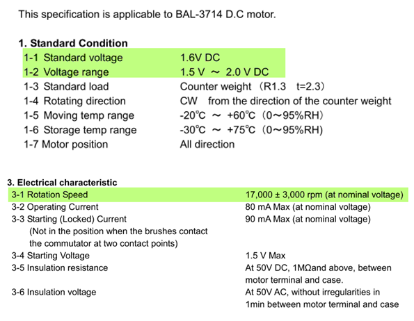

which actuator do you want to drive?
Hi, Jerry:
DRV2605 can certainly drive this ERM.
as this ERM only supports CW rotation, we should take care not to brake this ERM.
