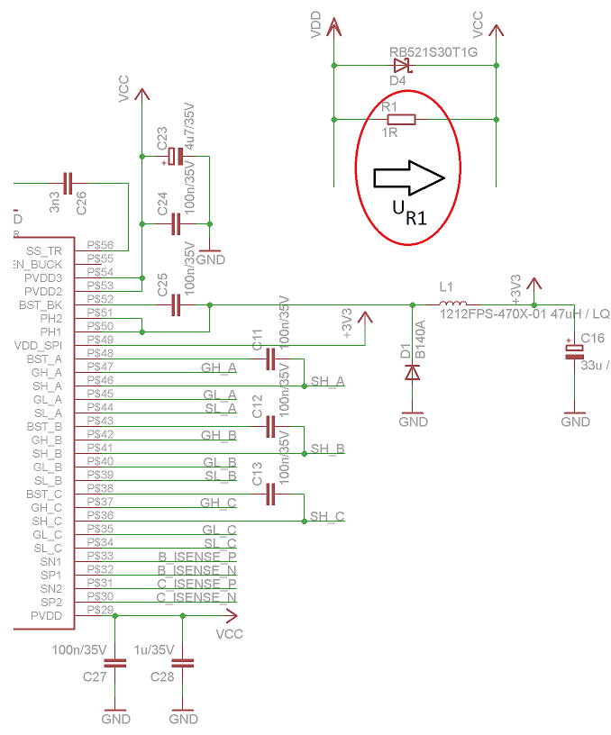

I am working on a desing with DRV8301.
It works fine but I experience the circuit is warmer than expected.
The plan is to drive 3 or more Mosfets in parallel.
I have more prototypes and I measured the current to PVDD.
When I use 6pcs (1 in parallel) CSD18533Q5A with 29nC @ 10V with 45kHz and 8.3V I expect Igate = 29e-9 * 6 * 45e3 = 8mA
The supply current is 22mA. I'd expect slightly more than 8mA, but 22mA is too much (though still bellow 30mA maximum for DRV8301)
When I use 18pcs IRQF (59nC @10V), the current is much larger - 90mA, though theoretical one is Igate = 59e-9*18*45e3 = 50mA
I measured worse (150mA @45kHz) values for 6pcs of NTMFS4935NT1G (50nC @10V) but was not able to reproduce it other day with other day (then it was 30mA - still out of expected 14mA ). This actually initiated the investigation.

  • Hi Lukas,
    Are you measuring PVDD or GVDD current when switching? The calculation is for GVDD, the gate drive supply.
    How are you measuring this current; current probe, current meter, or some other method? What is the accuracy of the measurement device?

  • Hi Nicholas and Rick,
    Thank you both for your answers.
    I measure voltage dropout on 1R resistor in the PVDD and PVDD2,3 and subtract the value measured when the transistors are not switching.
    The current is proportional to the frequency (not mentioned in the original post).
  • Since PVDD2 supplies the buck regulator, is there any 3.3V devices that consume more power when the motor is switching? This might explain some of the current.
    Yes, it is expected the current will increase with switching frequency. The MOSFETs will require more charge.
    no, there is a negligible change in the current of the 3.3V circuit (different calculation).
    The fact that the gates are driven from GVDD helped me to identify that there is a DC/DC converter stabilizing some 10.5V on GVDD and it requires higher current (the power supply is 8.4V).
    Then taking into account efficiency of the stabilizer, burning energy on gate resistors and internal gate resistance, internal current of DRV it seems my measurements fit the theory.
    I even measured the gate charge "estimating of integral of the charging current seen on oscilloscope" and it's in range +10% from catalog value.
