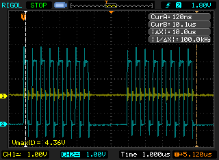

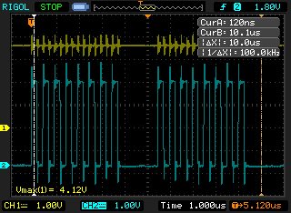

    The device is powered since the nFAULT LED is on. The SPI connections may be a problem. Can you provide a scope capture of a SPI write and read transaction? Using the Manual SPI Read/Write is the easiest method.
    Here are some scope grabs. Write operations seem to be working fine. Read operations, as expected, only read 1's.
    This is write to address 0x0 with data 0x000. Blue is the CLK SPI bus and yellow is the SDI.
    This is read address 0x0. Blue is the CLK SPI bus and yellow is the SDO.
    This is write address 0x2 with data 0x0F0. Blue is the CLK SPI bus and yellow is the SDI.
    This is read address 0x2. Blue is the CLK SPI bus and yellow is the SDO.
  • I'd also like to note that the SCS bus is operating as expected (high during the duration of the read/write operations). I only have a 2 channel scope, so couldn't also display it.
