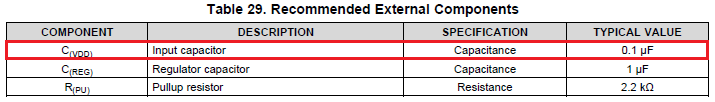

My customer found a recommended value of input capacitor was updated from 1uF to 0.1uF.
Is it still possible to use 1uF?
I would also like to know if it is possible to use 10uF.

For the input capacitance on VDD, it really depends on the how much noise is on the power supply line. If you think you may have a little more noise, then I would use the 1uF. Otherwise, the recommended 0.1uF is recommended.
Regarding the 10uF, I don't see anything wrong with using a larger capacitance(not considering ESR), but it is not really needed for the VDD pin.
Is there a reason as to why your customer wants to use a higher capacitance?
I believe there isn't, he wants to know just in case.
