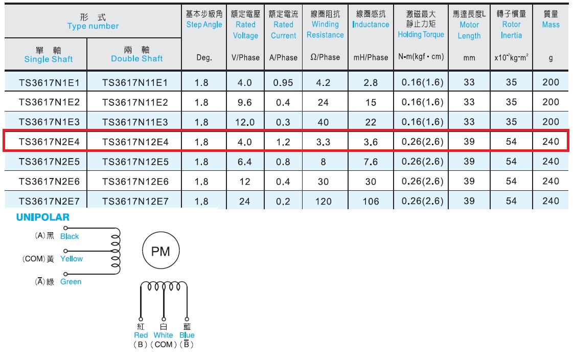

My Motor spec as below red mark
I would like to know which solution is suit for below motor ?? DRV8880 or DRV8846 ??
I hope have autotune function ,
Another question ,I have another motor can support 1deg/step ,which solution can support both of solution

  • Dear Duncan
    About our motor 's SPEC ,It is a unipolar motor ,rating current 1.2A ,rating voltage VM is 4V and 1.8deg/step
    Do you have suggestion unipolar motor driver solution could provide??
  • Hi Kai,
    Please look at the DRV8803, DRV8804, DRV8805, and DRV8806. All four have similar outputs for driving a unipolar stepper motor. The difference is the input interface. None of the devices have current regulation, so one approach to limit the current is to use the DRV8803 with a PWM interface.

  • Dear Duncan
    Thanks for your help ,if i change the motor VM from 4V to 12V ,which hero product you will suggest ?? DRV8805 or DRV8806
    I have another SPEC need to do 0.9°/step ,spec is like below (6 wire / unipolar / 0.4A)
    Do you think DRV8806 or DRV8805 can do 0.9°/step ??
  • Hi Kai,
    The DRV8805 or DRV8806 are both capable of driving the motor. It is up to the customer to decide which interface is preferred (STEP/DIR or Serial) or if there is another reason to prefer one. The DRV8805 has a higher voltage range. The DRV8806 has open/short detection.
    Yes, the DRV8805 / DRV8806 can move the motor above at 0.9 degrees / step.
