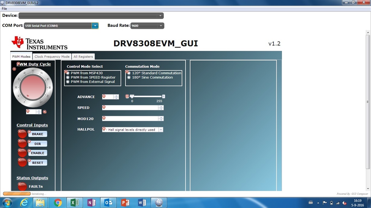

    Here is the screen i am stuck in. 1 Board is reprogrammed with the firmware that was delivered with the GUI and the other board is still the default firmware in the MSP.
    This problem is on 3 computers with Windows 7 and 2 DRV8308EVM boards... Mine guess is that Gui composser is missing some library for Uart.... But at this point i dont know where to start searching.
  • Hi Vincent,
    The red Xs indicate there is no communication between the GUI and the MSP430.
    Please make sure you have installed GuiComposer Runtime version 5.5 or higher. Link to GUI Composer Runtime is HERE. Earlier versions do not have support for the UART I/F of the MSP430. This is documented in the User guide.
