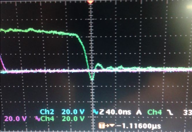

    Please examine the SH_x pins for negative voltages. Please let me know how low the voltage is with respect to PGND.
    A scope shot would be ideal.
  • Hi Rick,
    It looks as though the SH_x pins are getting between 10 and 15v below PGND. We didn't run it as hard as the failure points and the transitions seemed to get smaller with high current (although that could simply be due to the commutation point moving slightly). I'll try a Schottky on th e SH_x connections as well as clamping the gates.

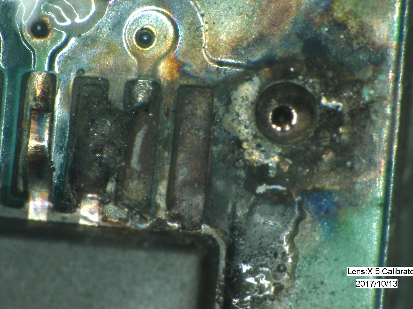

    More catastrophic failure, we placed quite a bit of protection circuitry around the MOSFET gates to protect them against Vgs failure modes. These came from the Automotive 48v 1kw Motor Drive design, TIDA-00281, schematic that uses the same MOSFETS but a different gate driver.  While the MOSFETs don't appear to be damaged the DRV8301 vaporized three pins and blew a hole in the package. PVDD1 pin is gone. This failure looks similar to the one described in this post (e2e.ti.com/support/applications/motor_drivers/f/38/t/200671) but more dramatic"
    We were also unable to remove the DRV8301 intact from the board so I've attached pics of the damaged section of the die. This chip was sourced through Digikey. We were exercising the circuit quite vigorously at the time with high current (+50A) pulses through the MOSFETS and trying to generate the maximum BEMF that the circuit would receive. The power was being supplied by a LiFePO4 battery pack that was quite capable of sinking any generated current. We currently have 5 ohm gate resistors so we'll increase those to 10 ohm, turn the gate drive to minimum and increase the dead time to maximum value. Any suggestions will be greatly appreciated.
