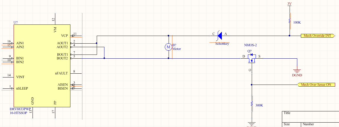

Is there a motor driver with the feature to detect if motor is connected or not ?
For example a driver connected to a DC motor
In idle state (no motor operation), the motor can be disconnected machanically from the driver.. so i need to detect it

    This is a DC motor that runs from 6v-8v battery with avarage current of 1A (can reach to 4A for very short time at stall)
    Your solution is good for startup.. but i need a solution for system idle state - i need to know immidiatelly (interrupt) when motor is mechanicaly disconnected from the driver

  • Hi Eduard,
    As I understand it, you want a monitor that alerts you when the motor is disconnected and the motor driver is idle.
    By idle state, I am assuming you mean the motor driver is asleep. Is that correct?
    There are two methods shown below. One is interrupt
    You can adjust the resistor values as necessary to minimize power. If you are extremely power sensitive, there could be other methods to turn the load on and off.
    Please note this is a concept; it has not been debugged.

  • Hi
    Tested method 2 - something isn't working for me, still investigating to find out what exactly i did wrong or didn't took into account
    When motor is connected - i can see logic low at "MECH Override INT"
    BUT - When motor is disconnected - there is a current path into the DRV output so i can see Approx 1.5v on the "MECH Override INT" and not the 3V...
    What is the exact state of the outputs ? What do you define as Hi-Z ? pulled to GND/VM ?

  • Hi Eduard,
    As you found, there is a path that consumes current in method 2. Using the 100k resistor limits the current to ~15uA. If you want to raise the voltage at "MECH Override INT" node, you can decrease the resistor to 10k. The down side of this is the current draw will increase to approximately 80uA.
    From the circuit provided are you polling the "MECH Override INT" node at a low frequency? If you are, please consider modifying the circuit to insert a second NMOS transistor between the "MECH Override INT" node and the schottky diode. The drain would be connected to "MECH Override INT", the gate connected to "MECH Over Sense ON", and the source connected to anode of the schottky.
    By doing this, you can reduce the average current by the operating duty cycle. For example if you measure the current for 1ms every second and the current is 80uA, the average current would be reduced to approximately 80nA assuming there is very little leakage in this configuration. TI femtoFETs ( www.ti.com/.../femtofet.html ) are ideal for these applications due to the size.

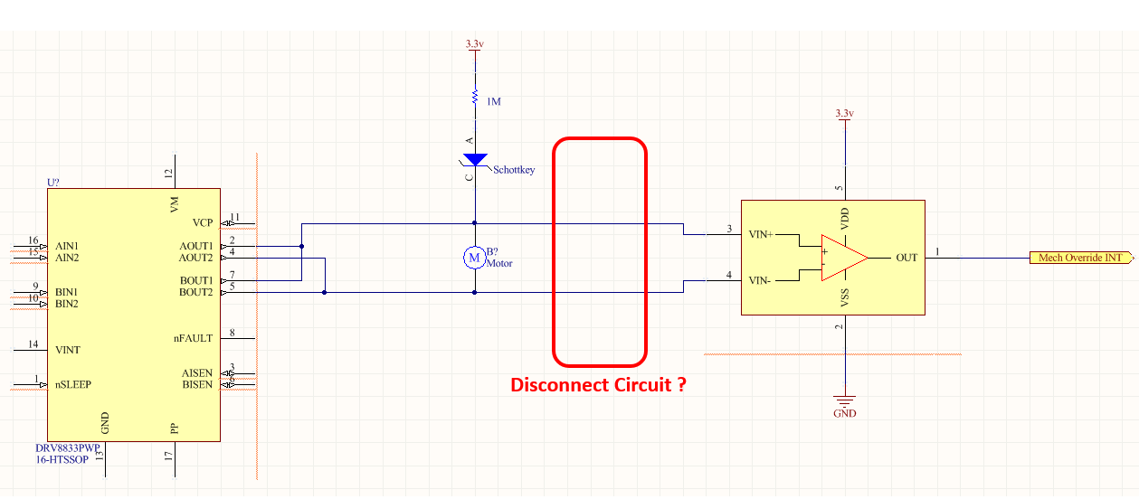

  • Hi Rick
    I tried in the lab the next solution, seems like it works good
    My question is - should i disconnect the comparator from the motor before motor's operation ?
    Is there any concern that the comparator will affect motor's operation and/or DRV sensing (current, fault etc')
    There is different tolerances for comparator's input impedance, for the DRV also..
    So what do you think ?
    If so, how do you suggest to disconnect it ?
    Eduard
  • Hi Eduard,
    The comparator should not affect the operation of the DRV8833, but the DRV8833 may affect operation of the comparator.
    What is the input voltage rating of the comparator when VDD=3.3V. Are there some paths that could raise the VDD voltage?
    If there are, you should protect the comparator. This can be done by either:
    A CSD13381F4 can be placed between the motor and each input of the comparator to connect/disconnect OR
    After confirming with the comparator manufacturer, possibly adding resistors from the motor to the comparator to limit the current.
