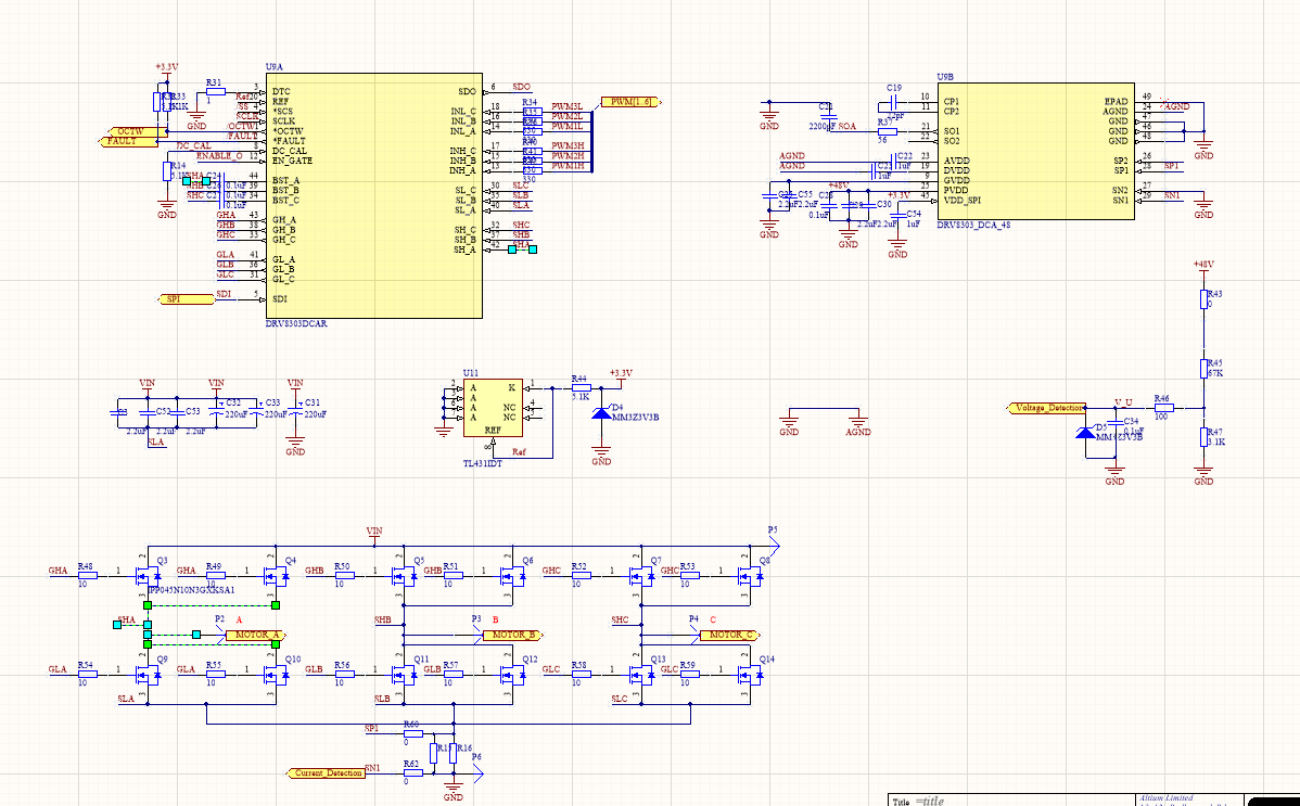

DRV8303: Over-current mode didn't get corrent current
Part Number: DRV8303
Other Parts Discussed in Thread: TL431, DRV8301
I am using DRV8303 to drive 48V/60A BLDC trapezoidal motor. My FETs Rdson = 4 mohm.  When the current runs up to 15Amp, The OC mode start to work.  But the over current should be 0.403V/4 mohm =  100 Amp.

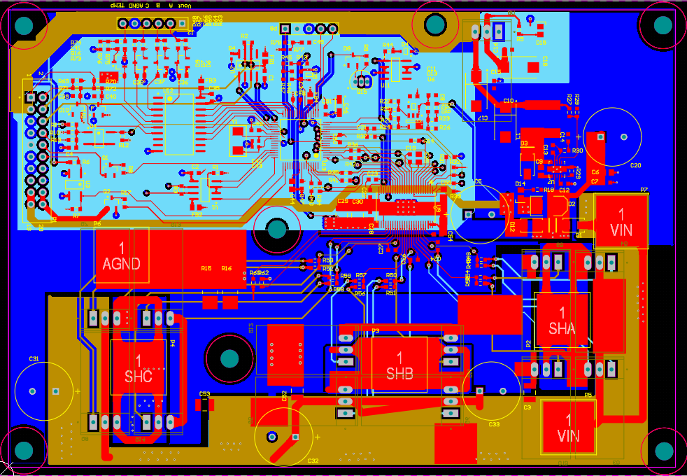

Do you think is my PCB layout issue?
I attached schematic,  PCB without top layer. Please check it.
