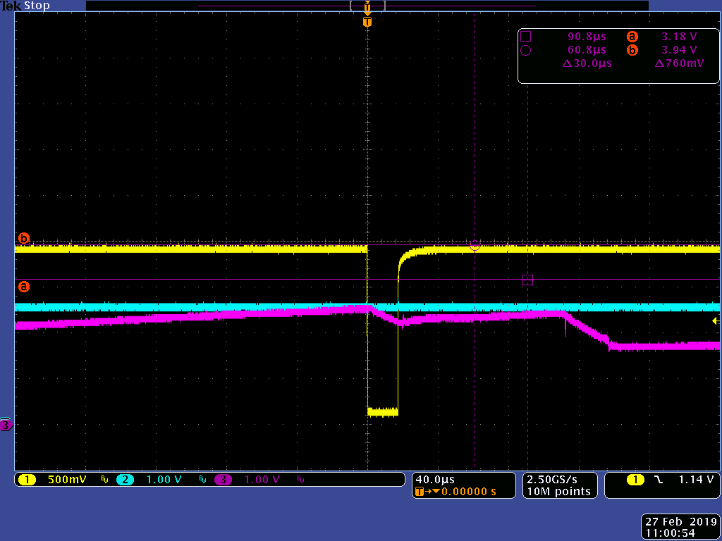

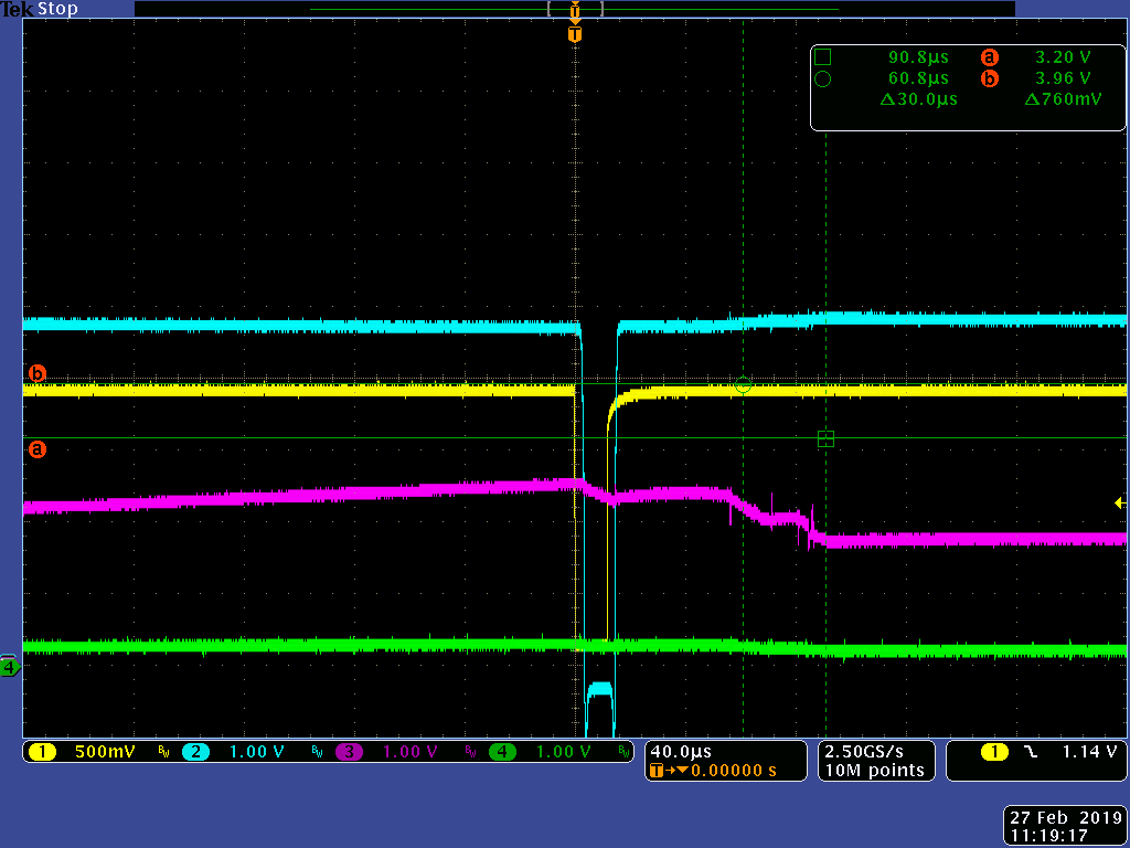

    I am working on the PWM control mode. The dual output is in reverse mode. I set the IMODE to 20k. I turn the IN1 PWM to completely counter clockwise and turn IN2 PWM to completely clockwise. Then the nFault is always low. When I turn a little back the IN2 PWM, then the motor can work normal. The waveform show in below. Thanks for your support.
     CH1: nFAULT, CH2: VREF, CH3: IPROPI
     CH1: nFAULT, CH2: OUT1, CH3: IPROPI, CH4: OUT2
