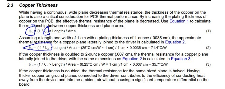

Please clarify the legends.
Thanks alot Rick. I am designing the thermal PAD with the dissipation so that, I can reduce the R-theta-ja from 27.8C/W to 25C/W can you suggest the optimum copper area to be used.
