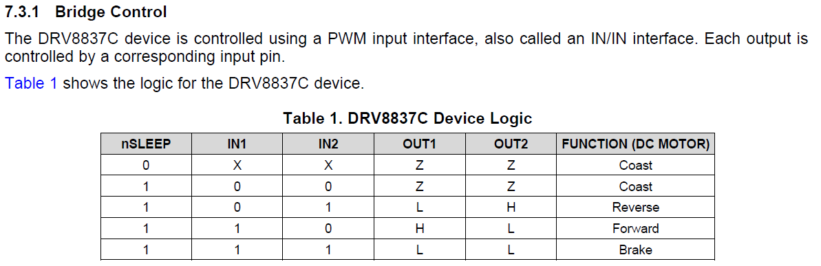

Hi TI:
Can DRV8837C keep constant output voltage?I just don't need to switch PWM, I just need a few HZ, one time period output is positive, another time period output is negative.Thank you very much!
Hi TI:
