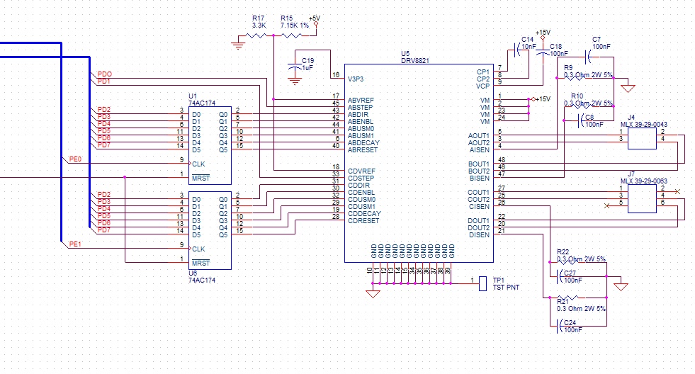

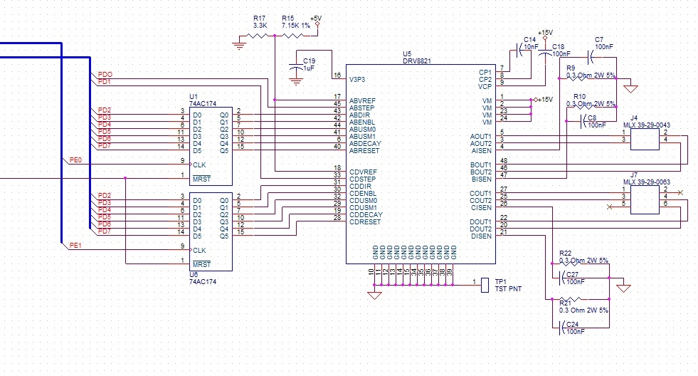

Attached is a picture with the design of the DRV8821. It is connected to a microcontroller. J4 and J7 connect to 2 bipolar stepper motors.
The signals provided by the microcontroller are as follows:
STEP=pulse
DIR=0
ENBL=0
USM0=0
USM1=0
DECAY=1
RESET=1
0=logical level low; 1= logical level high. Pulses are applied but the motors do not react. It looks to me like the device is in disabled mode.
