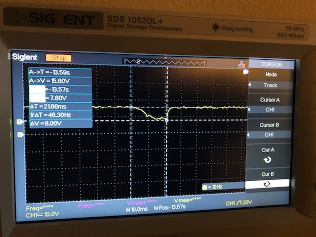

Hi, I recently purchased a DRV 8323RS Booster Board to run an FOC algorithm (3x PWM mode) using a Tiva C MCU (80MHz system clock) and an absolute position magnetic encoder. I am testing my algorithm on a hobby brushless motor DYS D2836 (~91mili ohms phase resistance, ~11uH phase inductance, and 0.001 Wb phase flux linkage, 7 pole pairs). PWM frequency is 5kHz (up-down counting) and VM is 15V, amplifier gains are set to 40V/V and the sampling is synchronized with the PWM (i.e. interrupt when PWM counter of phase A = 0, or LS gates are ON and HS gates are OFF) and all 3 generators are center aligned. TDRIVE is set to 2000ns and TDEAD to 400ns, HS gates set to 60mA for a rise time of ~100ns and LS gates 120mA for a fall time of ~50ns. I've checked the math of my FOC loop and it works fine. Current and position sensors outputs scale appropriately.
Problem: I'm using a switching power supply for my VM of 15VM. As soon as I run my algorithm I keep getting UVLO faults and my power supply dumps a lot of current (e.g. reaching the limit of my supply of ~5A). Based on the data sheet regarding Power Supplies, this failure seems to fit a low bulk capacitance problem. I think my bulk capacitance was not high enough (e.g started with a single 100uF electrolitic cap between power and ground), but the problem continued. Thus,  I've added five 10uF electrolitic and five 22uF  electrolitic capacitors between power and ground of my power supply to increase the capacitance, but I keep getting the same UVLO fault, the same large amount of current, and VM drops by 7V.
Questions:
1. Could this fault damage the Driver and/or mosfets?
2. How can I properly size caps for bulk capacitance?
3. Do you think the root cause is related to a different topic and not bulk capacitance?

    Do you have a bench lab power supply that you can try? I'm wondering if the supply you are using is fast enough to keep up with the current demand.
    Have you checked section 10.1 (Bulk Capacitance Sizing) in the datasheet?

  • Hi Adam, thanks for the follow. This is the power supply I have:
    15SDS019-3010D-09.V1
    I got this from Amazon, so not sure if from the specs you could tell if this supply is suitable for this application; the current can still go up to 10A, but I'm hesitant on increasing the current. Could you recommend one so that I can check it out? Also, I did check section 10.1 but the data sheet states that bulk cap sizing is setup dependent, so not sure from a design perspective how to derive the capacitance that is needed to prevent ~50% voltage drop.

    Could you explain why your PWM frequency is so low? 5kHz seems too low and may cause issues. You could try doubling it and checking if it helps the issue.
    Do you have an oscilloscope that you can use to check the VM voltage near the DRV?

  • Hi Adam, I started with 10kHz PWM frequency (or FOC sampling rate) but encountered this UVLO fault. I thought a lower sampling rate could fix this problem, but I saw no change. Below is a figure of the voltage drop. Note that once the MCU reads the UVLO fault I set the duty cycle of all three generators to zero, which is why you can see a fast voltage increase to nominal. In this figure I'm probing VM power to ground.
    Do you think this problem could be related to the starting sequence in firmware? The enable pin of the DRV is also connected to the low side gates of the DRV. So the first line of my firmware is the programming of my IO ports and then enabling the DRV pin. Afterwards I program the DRV registers: DCR, CSACR, OCPCR, HSR & LSR. Lastly I program my PWM module and enable the PWM counter interrupts.
    Could I get your thoughts on other things that I could try?

    Do you know the start-up current requirement of your motor under your load conditions?
    It's hard to debug this remotely as I don't know your algorithm or motor.
    -Adam

    Below, the yellow probe is VM and the purple probe is the high side source MOSFET of MOTC on the DRV8323RS boostxl. Note that this dip in VM is causing the UVLO fault. For this sensored FOC implementation, is it necessary to implement a ramp in DC?
  • Andres,
    It looks to me that your power supply is not fast enough or it cannot provide enough instant current to maintain the VM voltage.
    I would try another power supply or ramp the current slower.
