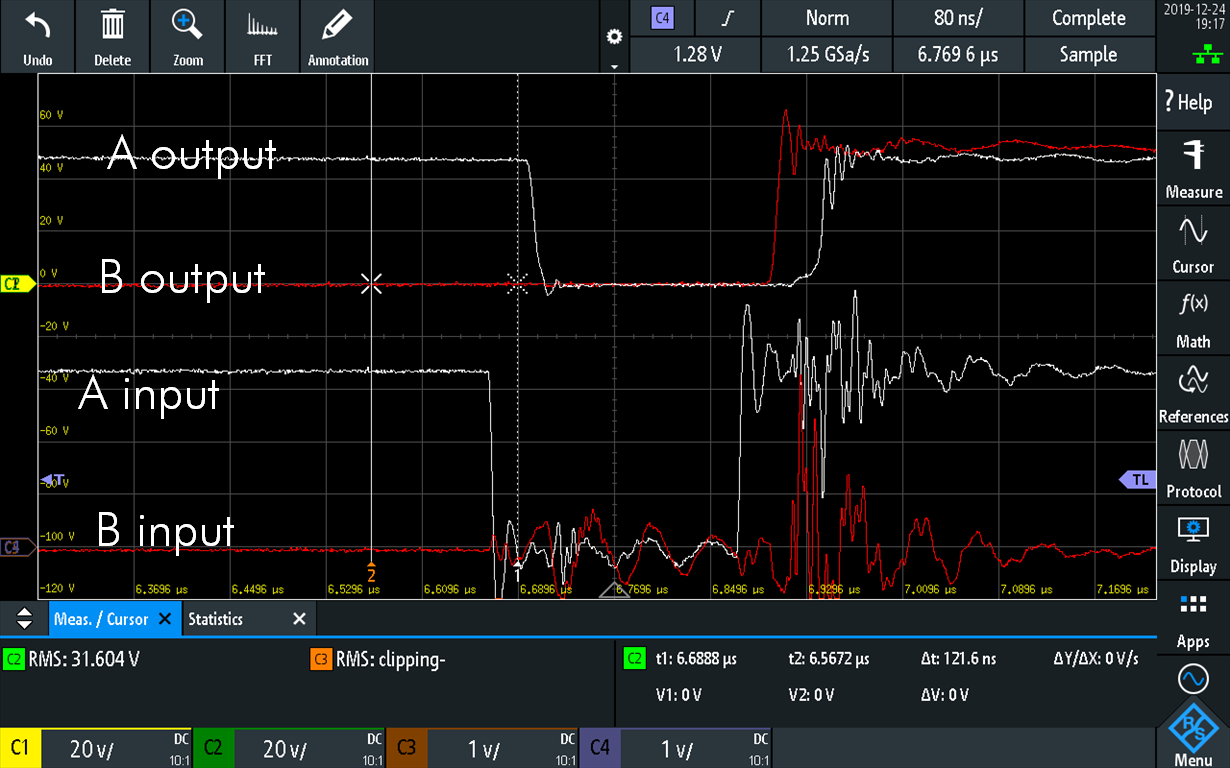

When running at close to 50V, the opposite high-bridge turns on spontaneously and only turns off when the CBC limit kicks in. I've attached some scope screenshots; the top two traces are OUT_A, OUT_B on the DRV8412DDWEVM and the bottom two are PWM_A/PWM_B.

    Also, can you compare the input signal with the output signal? What output waveform do you expect?
  • The opposite half-bridge is "A" turning on I'm switching "B" when A+B are in a full-bridge configuration, and vice versa.
    The input waveform is given in the oscilloscope screenshots as the bottom two waveforms, with each color corresponding to the appropriate output waveform.
    I changed the output transformer (I had a suspicion that the previous transformer was saturating) and the problem disappeared. However, I'm still wondering why it happened in the first place.
    Quick schematic:

    I've annotated one of the screenshots
