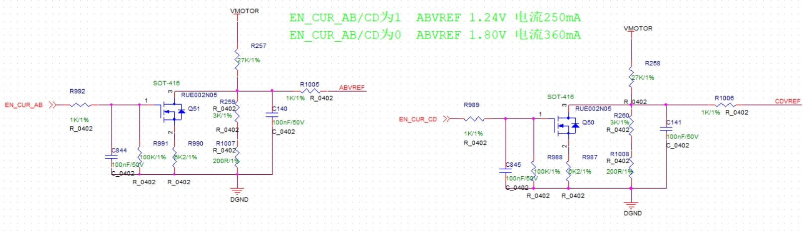

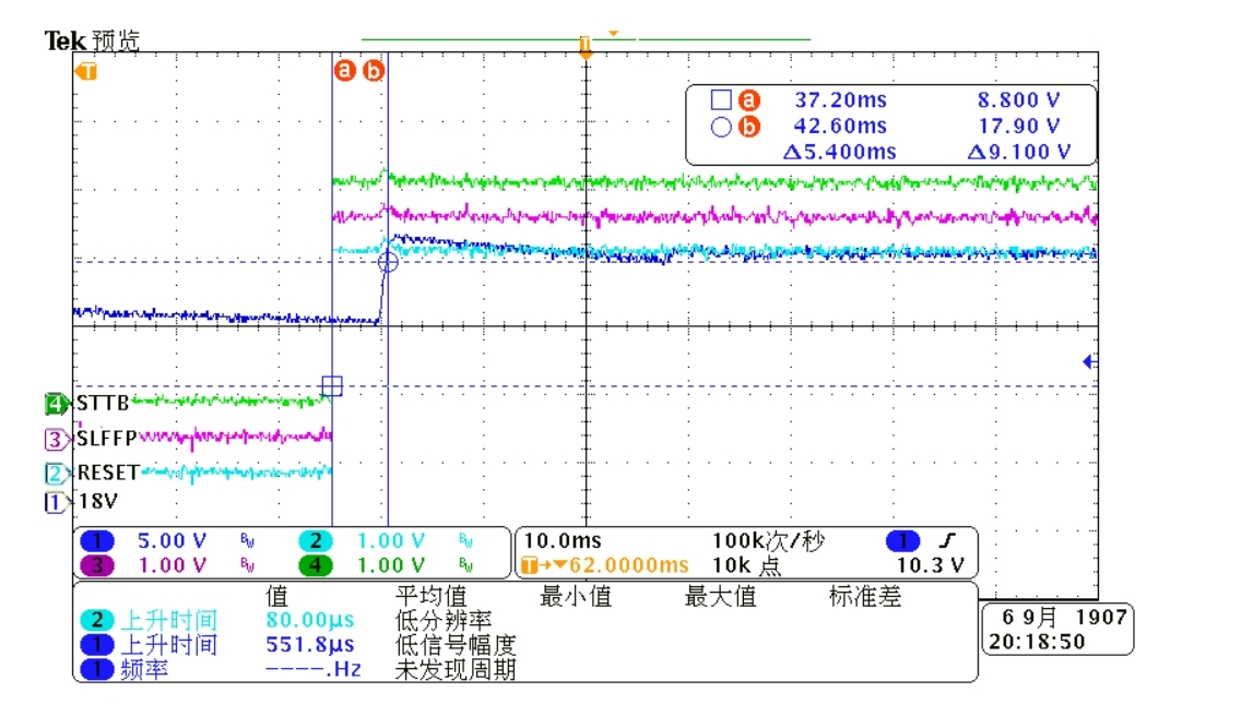

    1) SPI, A / B / C / DOUT / RESET / SLEEP / SSTB voltage ok at low temperature, low-temperature startup waveform is as follows, and there is no change in timing at normal and low
    2) A / B / C / DOUT output is 0 when not starting at low temperature

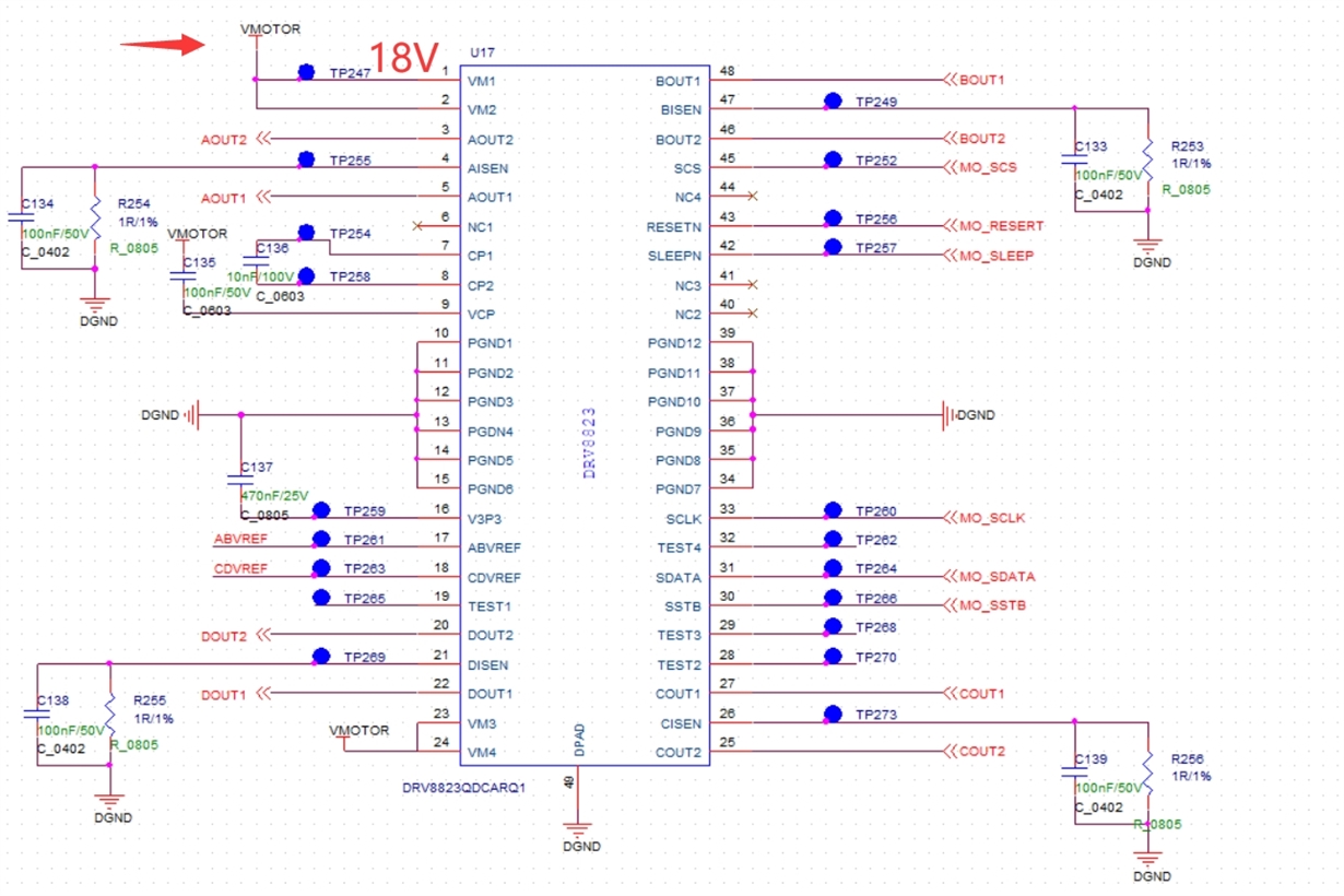

    4) At present, it can be confirmed that at low temperature, when the DRV8823 has no output current, restart the VM voltage (disconnect and reconnect), and the 8823 output is normal. But reset RESET does not make DRV8823 start normally
    5) Peak working current of stepper motor is 860mA at low temperature

    When restarting VM and resetting through RESET, are serial commands re-sent to enable the outputs?
    Also, is it possible the VM voltage is dropping below UVLO on some boards?
    I do not see any capacitors on VM, and I see 18V at 13V in one scope plot.
    In my opinion, this appears to be something that is marginal
    Please ask the customer to look for differences (voltages and currents) on a working board and non-working board.
