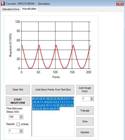

May I use DRV2510-Q1 EVM to generate negative output? Could you help provide an example of setting or waveBulider example in Console?

There are many ways to generate a negative output. It is necessary to remind that the OUT- must have a duty cycle higher than 50%. In that way, the expression OUT+ minus OUT- will result in a negative output.
- If the analog input IN- has a higher voltage than IN+, the output will result in a negative signal.
- In case of the wave builder, you may set points below 50% as shown in the picture below:
Please let me know if you have additional questions or comments.
