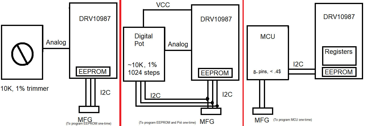

    I have updated 3 possible solutions for Motor speed configuration - see attachment for block diagram
    Need:
    1) Motor should run at pre-configured one speed only
    Option-1, I2C: using MCU to control registers using I2C  (last pic)
    Option-2, Analog-i: using Digital potentiometer/Rheostat (center pic)
    Option-3, Analog-in: using 10K, 1% potentiometer/trimmer (first pic)
    Even though option-3 is the simplest one, I'm not finding low-cost 10K, 1% potentiometer/trimmer. Whether TI has low-cost solution option-1 & option-2 mentioned above?

    Option-1: Can I use MSP430G2230 to one-time program of all registers (including EEPROM) of DRV10987 using I2C interface? Is MCU's RAM & Memory is enough for one-time programming?
    Option-2: I'm not finding ~10K, 1%, 1024 steps digital pot in TI
  • Hi Sadashiva,
    Option-1: You can use MSP460G2230 to program the registers via I2C. I don't see any issues using this MCU.
    Option-2:  I think using a 256 step 100k pot will give a good resolution. Resolution of 256 step 100k pot (http://www.ti.com/lit/ds/symlink/tpl0102-100.pdf) will be 0.39 kOhms. Converting this to voltage (full scale - 3.3V) will give a resolution of 12.87 mV. Using a 128 step 10k (http://www.ti.com/lit/ds/symlink/tpl0401b-10-q1.pdf) will give a resolution of 26.4 mV. Since you mentioned you will spin the motor at a fixed speed, programming the digital pot to a resistance close to the desired speed pin voltage should't be challenging in my opinion.

  • Thanks for confirmation on the following -
    Option-1: MSP460G2230 RAM & FLASH capacity to program all I2C registers
    Option-2: 8-bits resolutions for Analog In
