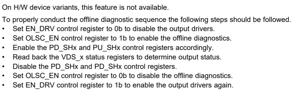

If Motor Predriver output connected to BDC Motor still i can do Offline Short Circuit and Open Load Detection (OOL and OSC) Related Diagnostics Since my motor is connected??

    To have offline short circuit and open load detection, datasheet lists the diagnostic sequence.
    I didn't know your "motor predrive output" detail. But, if you can follow that sequence, the detection is available.
